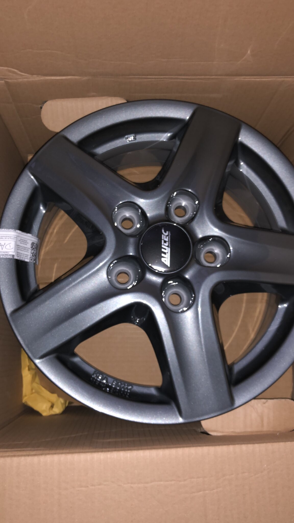

If you lived near where I work it’s a pack of biscuits, we have two weighbridges (in/out) and I use them as and when I need to. The trip to work last week made up my mind to uprate to 5ton so uprated wheels on this afternoon, all stuff sent into Van Weight Engineering on Monday and sit back and wait for the uprate to happen and hopefully the dvla will get it right first time🤞👍
I take you changed the tyres as well?
DVLA get I right first time - in your dreams.
Yes 1450kg wheels and 121 rated tyres (winter ones😉)👍
