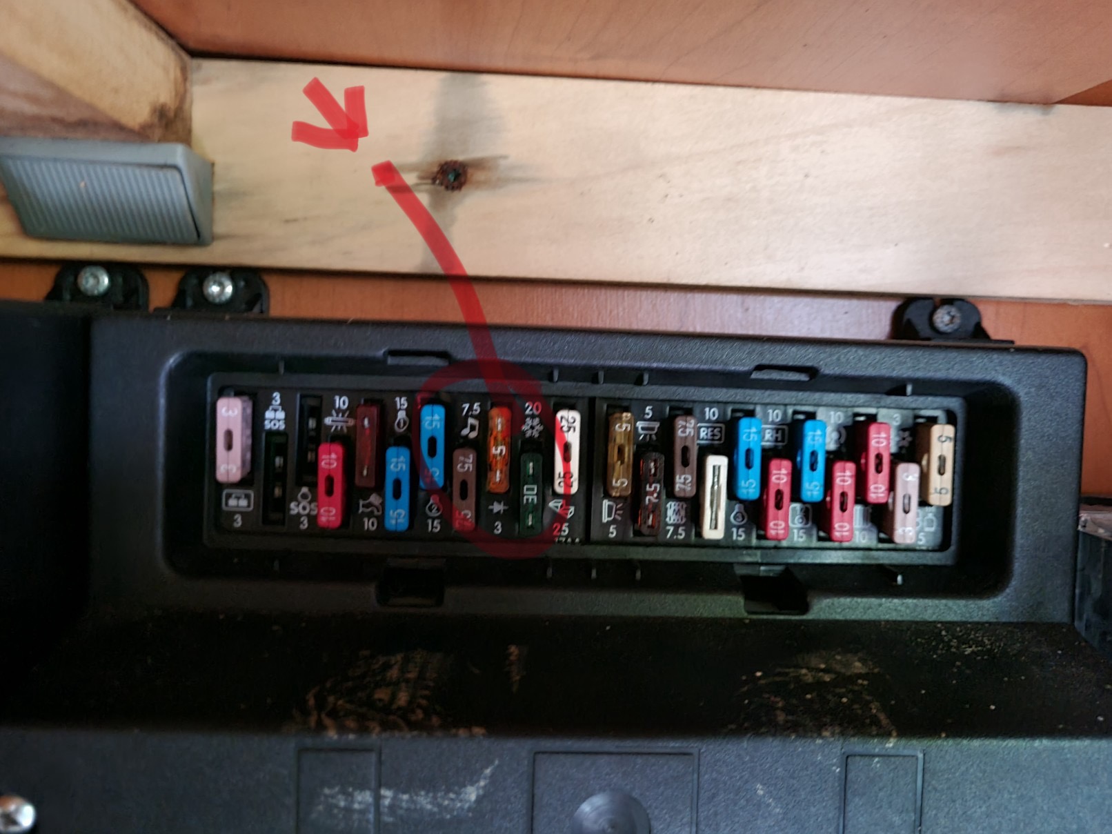

When we picked it up sos was empty but I think the one next door to it the lights also a 3amp but had a 5amp fuse in it was blown, replaced with a 5amp as we didn’t have a 3amp at the time… I’m saying this for info only…

Sorry the fuse was this one…
3amp/5amp sounds low for the SOS fuse as it normally powers several lights and the water pump, may also power the heating circuit.
My mates E line it was 15 amp.
The fuse box tells us the fuse ampage though it's hard to see in the photo but there's a raised number beside each fuse with the ampage I've currently got a 5amp in the control panel holder as we didn't have a 3amp to hand but I think I have them in another box I just have to find them .
