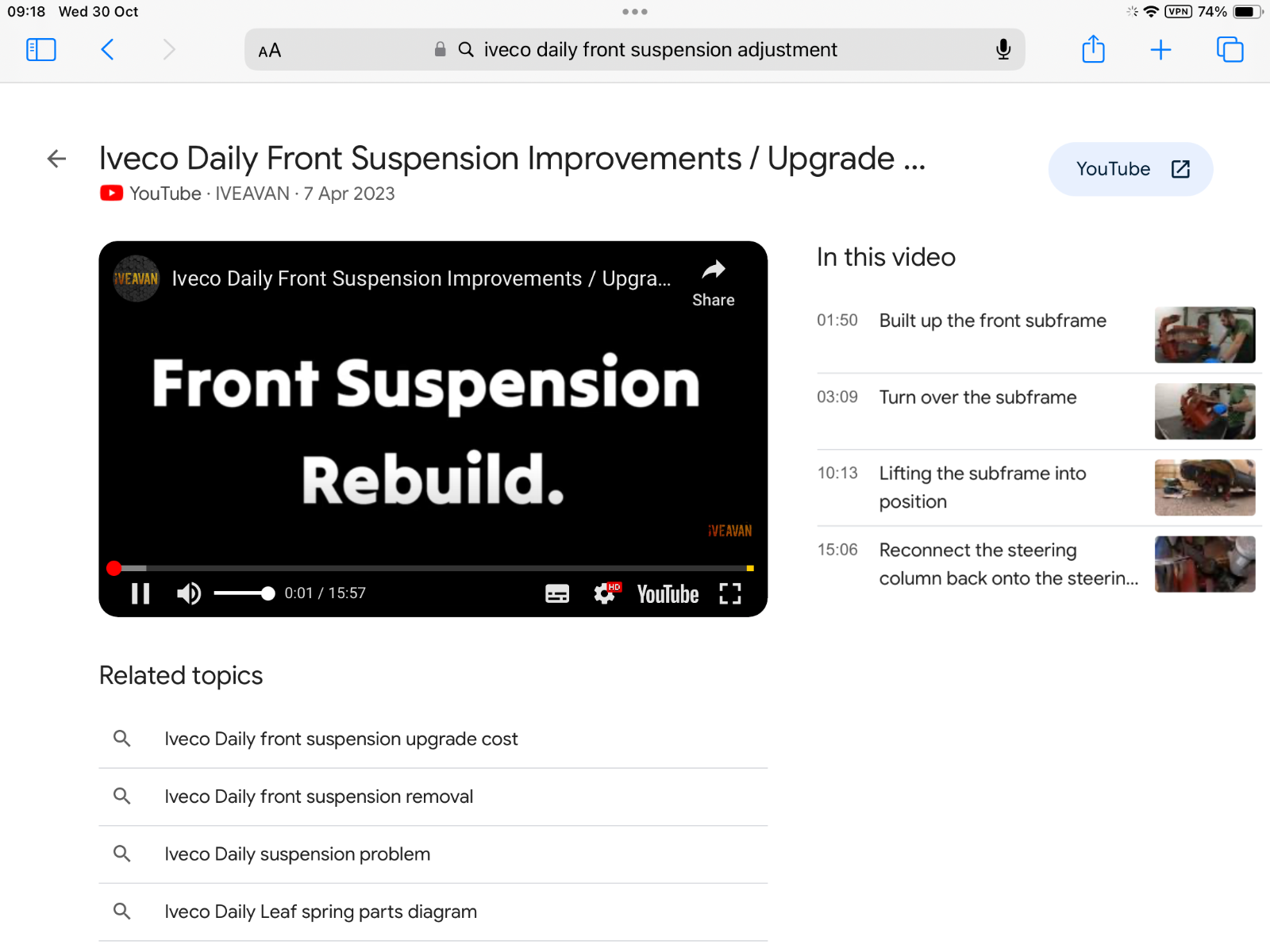

Tam have a look at this video

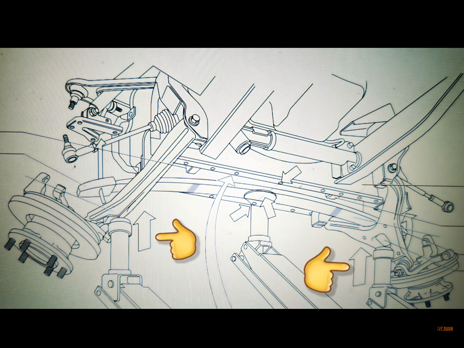

Tam has yours got the rubber buffers to alter ride height?
Hi Brian, Tam's is different as it has torsion bars for the front suspension rather than transverse leaf spring, his ride height adjustment is on the back end of the torsion bar.
