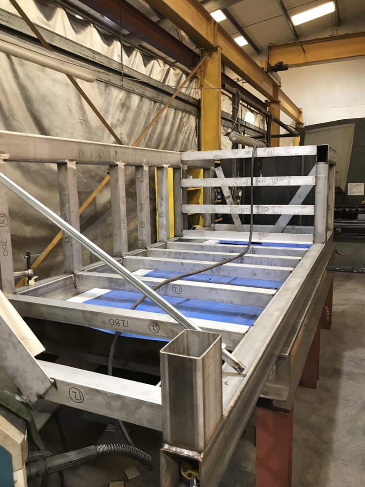

First wall ?
Are you cutting the back of the cab out and blending box into cab?

Perfect example of chassis twist!! Hope that's given you more of an idea for your build HandyAndy
Once I work out where to put the springs ?
Presumably between existing original chassis rails and the channel section that runs the length of the bed on top of the existing.
