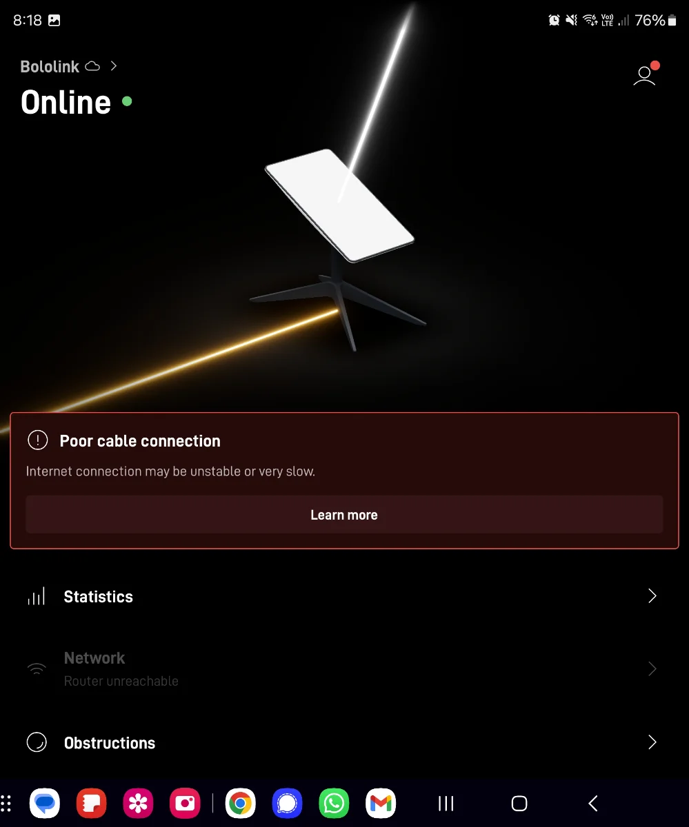

Has anyone had the below...ive checked all the cables, all seem.fine. rebooted a few times amd connection seems to drop out after a few minutes.
I clicked the cable error message and was taken to a "how to page" then a page that said a new cable has been ordered and is on its way.
I'm not sure it even is the cable.
Just strikes me as strange, never even spoke to me on email or whatever.the cable itself was clipped in position 12 months or so ago and has never been touched. It's on a static in Wales.I had a cable failure just over a year ago. They sent one out very quickly FOC. Ever since I’ve been extremely careful with the cable.![]()
We will see when it comes.
Makes me feel they know some cables are suspect to just send one out.

Just for information.Just strikes me as strange, never even spoke to me on email or whatever.the cable itself was clipped in position 12 months or so ago and has never been touched. It's on a static in Wales.
Very strange, mines been on the roof nearly 2 years with no issues. I don't move mine at all as it's just constantly plugged in. Mine will be a pain to replace as would have to remove it from the roof to do that. Hopefully that won't happen anytime soon. They must know about it though as no way they would just send out a cable without any troubleshooting.Just for information.
Cable arrived 48 hours, replaced and back working.
But as I said, strange. This cable was clipped in place right up to the plug on router, never moved never touched, and failed.
Me thinks they know they are suspect. But can't knock the quick replacement and a month's service credited.
Yeh it was the app itself that said you seem to have a problem.with the cable, so.maybe the ping or whatever gives em a heads upVery strange, mines been on the roof nearly 2 years with no issues. I don't move mine at all as it's just constantly plugged in. Mine will be a pain to replace as would have to remove it from the roof to do that. Hopefully that won't happen anytime soon. They must know about it though as no way they would just send out a cable without any troubleshooting.
Nice simple fix though.
Yes, increasing numbers of lost ethernet packets and transmission retries probably get reported by the dish to the app, and that would be a good sign that the cable is faulty, maybe due to water ingress?Yeh it was the app itself that said you seem to have a problem.with the cable, so.maybe the ping or whatever gives em a heads up
Mines ok so far but could this highlight a future problem in transferring to France using a random campsite as an address. Any parts needed would be sent there.Very strange, mines been on the roof nearly 2 years with no issues. I don't move mine at all as it's just constantly plugged in. Mine will be a pain to replace as would have to remove it from the roof to do that. Hopefully that won't happen anytime soon. They must know about it though as no way they would just send out a cable without any troubleshooting.
Good point, hopefully that won't happen but it's a risk none the less.Mines ok so far but could this highlight a future problem in transferring to France using a random campsite as an address. Any parts needed would be sent there.![]()
