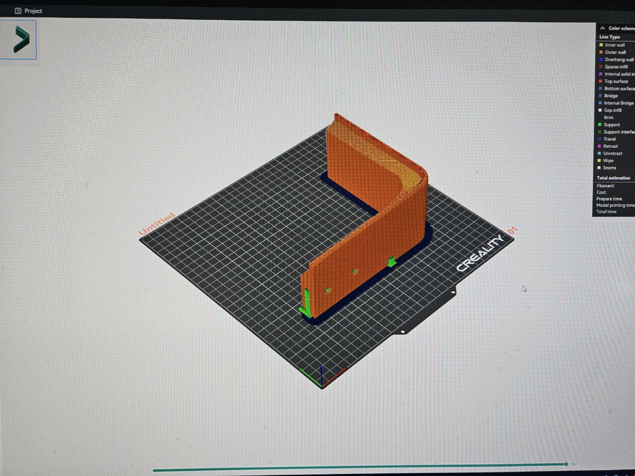

Plus here is a little short video of me printing one of the corners in ASA with the K1 Max.

looks really good and very fast !!! is everything you print on it with ABS succesful? i assume it comes with the slicing programmes etc already set for ABS plus the other filaments?
if only i had been a good boy over the previous 12 months, still, gives me the incentive to try harder next year !!!
These machines are incredible, fast and they work quite well out of the box.

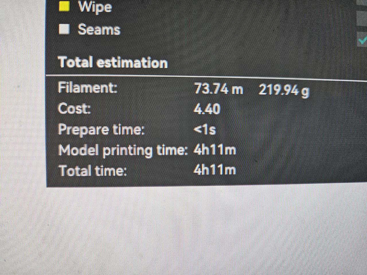

Impressive 4h 11 mins, my ender took around 19 hours for the same part.
Very envious 😁
The bambu x1c could print very fast but for me i prefer quality over speed anyday. My old prusa mk3+ was very slow but print quality was much better than the newer x1c technology.

So is that £4.40 in filament for that piece?
Yes based on generic prices but doesn't take into consideration electric costs, wear and tear etc etc
The whole 6 pieces takes approx 1kg of filament if I remember correctly. That's if they all print first time with no issues which is def not the case when printing ASA and ABS
