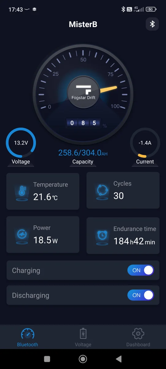

FYI
Fogstar Lithium 304Ah, Renogy 3000w inverter
2 pizzas just cooked on the table top pizza oven for something to eat before we go to the NYE party at the pub in Newent we're staying at ...
Around 8% or 20Ah Inc inverter draw
Result in my lithium world!

So I must be doing something wrong.....maybe I'm reading my stats wrong.
Bear in mind, I've been motorhoming for 20 plus years. My set up prior to this van was simply for 10 years, two x 120 amp batteries and an effoy, nothing more nothing less.
My set up on my new van that we've had since March is 3 x 110 victron lithium batteries,3 kw victron inverter charger, 200w of solar no B2B smart alternator. Never ever needed to think about power before, most places we stay a couple of nights, nikki uses hair dryer and we cook with an air fryer without issue.
We came away Friday, stopped the night in Stratford upon Avon, no hook up, arrived fully charged, lived our best lives and had an air fryer meal. I noticed we had hammered the batteries a bit, I noticed I was only putting in about 20-30 amps and the journey from Stratford to Portsmouth wouldn't be enough time arrive fully charged. I turned off the fridge, managed to get the charging rate up to 40 amps and arrived at Portsmouth with 98 percent battery.
We have stayed 3 nights with tonight being our 3rd and already the batteries are saying low charge. This set up comes in at over 8k factory fitted so I'm unsure why I'm in the dark?
My draw is about 3 to 4 amps even with everything seemingly switched off.

Or am View attachment 994946View attachment 994947i misreading something?
You arrived at Stratford with 98% SOC.
2 nights later ( part way into 3rd night) you are down to low voltage which means you've used most of your available nominal (330 - 2%)323.4 Amps. This suggests you are a heavy user.
OR, as you said you have a draw of 3-4A when all is seemingly switched off; 72-96A per 24hrs would explain low voltage after 2 nights.
In later replies, you say you believe you are not using any more power than you did when on lead batteries.
This suggests that your effoy in your previous set up was "masking" the low 240A (effective 120A) capability of the lead batteries, without an effoy they would have been low voltage much more often than Lithium, if you had a similar parasitic draw.
You really do need to find out what that draw is!
You ask how come you've had the worst performance ever in the depths of winter.
Diddly squat solar input, no ehu, parasitic drain.
If you had lead, you would have been on low voltage much sooner.
