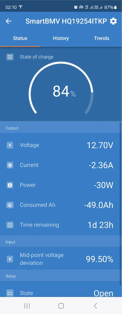

Fgs can someone explain what's happening here.?
Been out for the night, came back, checked batteries and I've more power than MisterB...
Never had this problem with AGM... when they were fooked that was that...
Did you reset that before you went out? So when you were not in your van, your van used 49Ah in one evening without you even being in it?

Grommet, most of what your saying, apart from the fridge, has been touched upon but put in different ways.
For example, I mentioned that the something different is the fact that he had an efoy in his lead system. Also said he would have had low voltage more regularly with his lead if he didnt have an efoy.
He's also been advised multiple times that the 3-4A draw when all is switched off needs to be looked at.
I mentioned that the 72-96A loss would quickly deplete the lithium and even quicker the lead.
