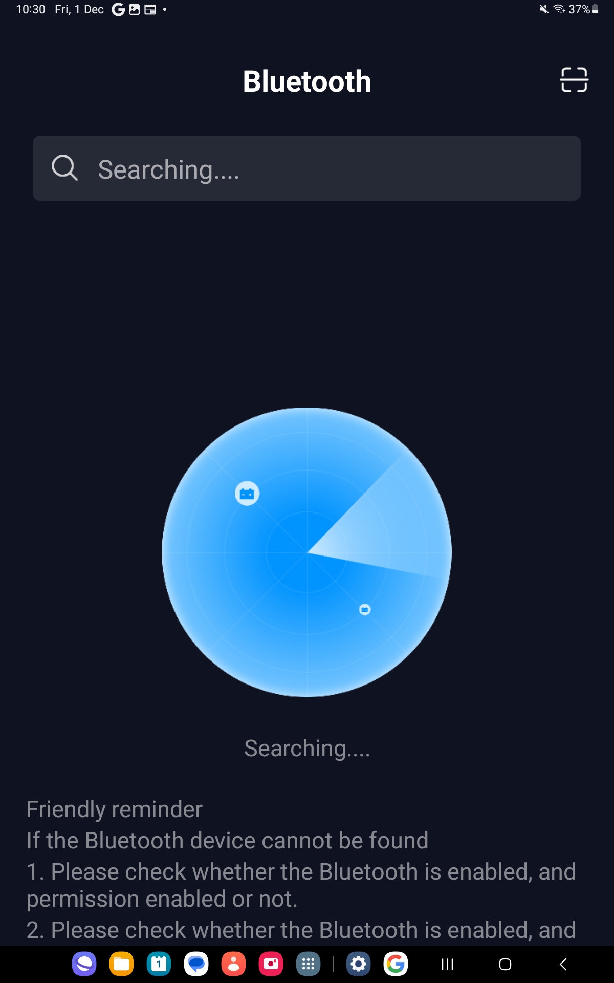

Anybody having problems with the app ?
I received 2 x 105AH Fogstar Drifts today.
I down loaded the app on to my phone but no matter what I do my phone just searches and searches and doesn't connect.
I have also down loaded the app on to my tablet but that won't connect either.
I have Bluetooth and location turned on on both devices and have uninstalled and re-installed the app several times on both devices but still no joy.
I can connect to other devices via Bluetooth no problem.

I've just spoken to Fogstar who can't explain why I can't connect to their app but have suggested a few things to try which I will try in a bit.

I've been doing force stop and uninstalling and re-installing the app since yesterday lunchtime, also turning Bluetooth and location on and off and forget paired devices, although it has never paired, with no luck
I am out of ideas sadly... what phone's are you using out of interest?
But the Bluetooth module doesn't know you've forced quit. It still thinks you are connected, so does not broadcast to other devices. This is usually fine, as then you reconnect from the exact same device, and all is well. The issue arises when you then try 16 new devices and it can't see the module, as it's still connected to the one you've forced quit.
Surely if I've uninstalled the app, turned Bluetooth off and 'forgotten' all paired devices then I'm not still connected ?

I have deleted everything and started from fresh numerous times.
I have tried connecting with the device actually resting on the top of the battery so I can't get it any nearer.
Agreed that once I've had a trip or 2 with the batteries I will just use my Victron smart shunt to see what is going on.
Luckily the app Fogstar sent me to try this morning seems to work fine so I have been able to see how the batteries are after their first initial charge and all seems fine (y)

I am hoping to try an iPhone this weekend just to see if that will work as what I've tried so far have all been android devices.
I have only ever used IOS and it works fine😊 hope you get it sorted👍😊

The issue seems to be with the Android app and the open platform that it sort of is. Apple stuff is more consistent with this stuff as they tie it down a heck of a lot more. EG: you cannot get a WiFi sniffer app on Apple as IOS doesn't allow anything other than Apple stuff to access WiFi, this may have changed but for sure it was the case for many years.
As I said in a previous post Bluetooth is not a standard and different manufacturers use different parts of it. EG: Sony would never stream track title or artist via BT, Samsung would. Older VW cars would only connect via RSAP to phones... complicated stuff.
I guess the BT in the BMS is getting locked up somehow or the phone doesn't like the app for a weird reason. Apple is IOS, that is is and no variation. Android is an operating system each manufacturer can "fiddle with" so every variant can't be checked by Fogstar or anyone else making an App.
FYI if I am having issues with stuff like this I will delete the app and reboot the phone before I try the app again. They have a nasty habit of remembering previous permissions / connections even when deleted... just as they can turn on data and wifi even if you set them to be off!! Sometimes too much tech can be a problem..:confused:

Yes I've rebooted the phone and tablet on numerous occasions with no joy.

Fogstar did say that my Huawei phone might only have Bluetooth 4 as opposed to 5 due to its age and that that could be a problem but said that that didn't explain why neither of the Samsung Tab 8's or the other half's Samsung phone wouldn't work as they are all Bluetooth 5.
I’ve just checked and my iphone13 phone and iPad Pro are both bluetooth 5👍
I did hear once (I think) that bluetooth and WIFI signals can interact - might be worth a try with wifi turned off on the phone?
