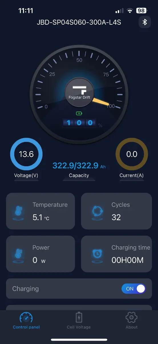

Interesting. Following the first full charge our new Fogstar 280ah battery, the Fogstar app reported 100% capacity at 299ah.
I only got 277 from a 280ah Fogstar battery and hasn't changed in nearly 2 years of use. Clearly some cells are better than others.
The new Fogstars, since early last year, have different cells and over their stated capacity.
For example my Fogstar 230AH is just over 12 months old and has always showed 230AH whereas Lenny HB has a pair of slightly newer 230AH 's and his charge to 244AH/245Ah iirc.
My 230ah purchased in June this year charges to 242ah, it was advertised as having an upgraded BMS from the previous batch when I bought it, which may explain the difference.
This is the reading today on my 330a Fogstar drift pro 👍😊
In my view, since the bms does not have the ability to measure current accurately, those figures are estimates only.
Imagine you start with a fully charged battery, and start drawing with low current, bellow the bms detection. The SOC will remain almost the same as it was not detected as a drain, but, you take some Ah out, and after that you charge with a current that's picked up by the bms, and counted up as Ah in. Your final capacity figure will increase.
True total capacity it is not given by bms, but a discharge test will. Then you enter that value into the bms to let it know what it has to work with.
I set my shunt up to the BMS figure on the first charge, regardless of having a light discharge or a very heavy discharge the charged capacity has always remained the same.
Also when comparing the SOC to the ah used it's nearly always within 1% on the shunt worst case 2% occasionally.
