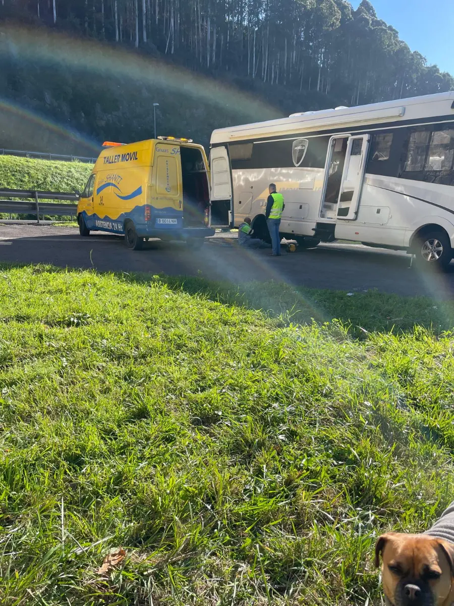

This was the van he turned up in 🫣🫣

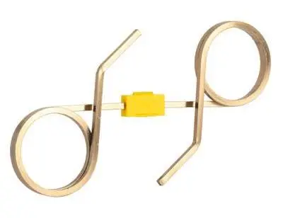

Maybe consider a set of wheel nut retainers in plastic or the metal clip versions as this would cause me concern going forward.
The repairing garage should be able to source for you and the plastic ones are available in several colours.
Oh s**t, doesn’t even look like a decent tyre fitter’s van as it looks empty.
