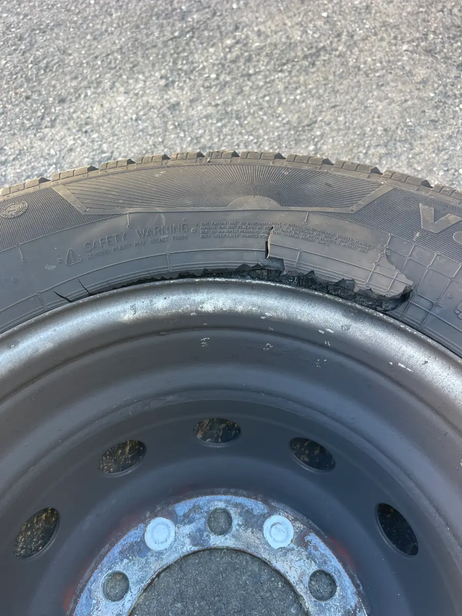

The tyre didn’t completely deflate, I had a warning on my tyre pressure system that the tyre was deflating and it deflated to approx 65psi before I managed to get to the SOS stop.
Are they going to replace the rims as well ?
The inner rim is damaged so will be binned. I will use the spare for now. Iam going to get 7 new tyres whilst here, 6 for the motorhome and one for the spare, although I won’t have a rim for it I will source a spare rim when we finally get to the Algarve and get the 7th tyre fitted to it.
I mean the spare will be binned (which was put on when I had the blow out on the original steel wheel) so ill get all round new tyres then source a new steel inner wheel and use that as my spare
