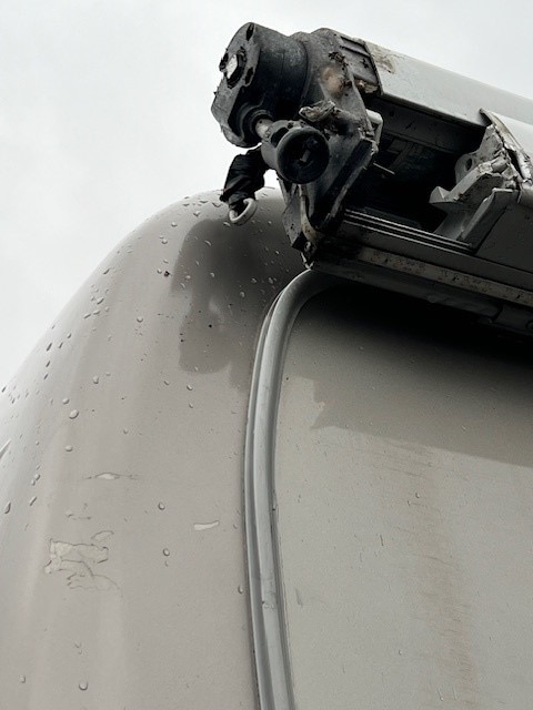

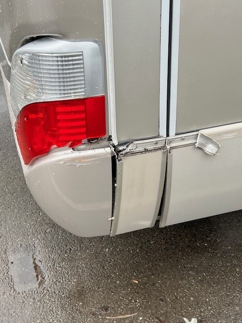

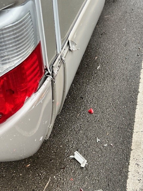

Just took a call from Mertrux, hoping they were going to be giving me a positive update 👍
No, still waiting for parts 🤔
But, a lorry has just scraped down the side of your MH 😳
Driver admitted it, awaiting a photo 🤔🙁
If it was parked on Mertrux premises, do they not also have a 'duty of care'? 🤔
