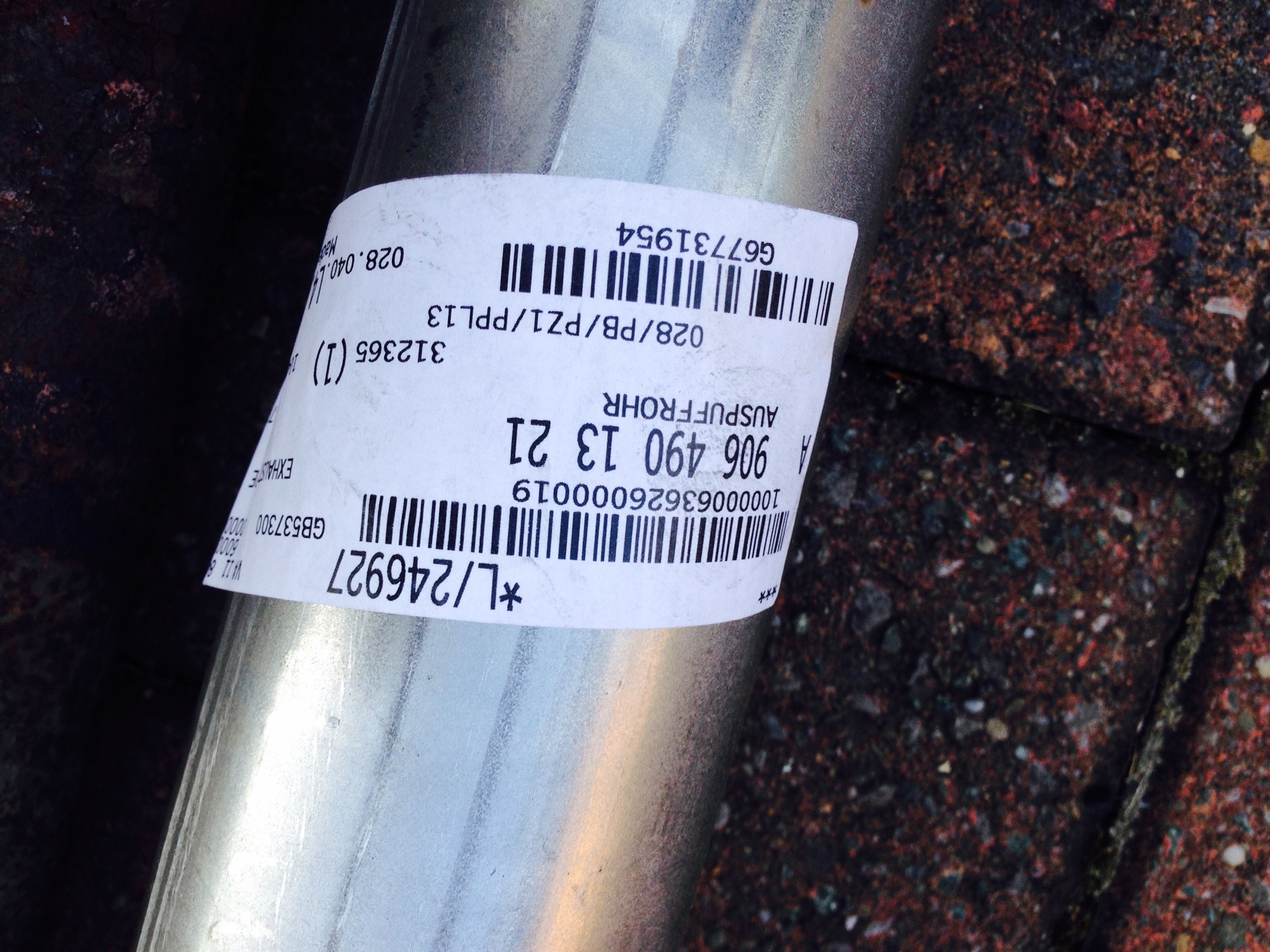

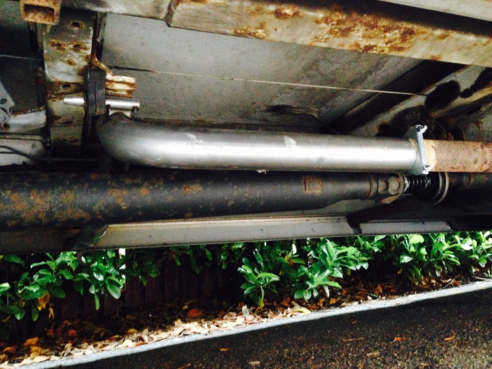

The idiots at Mercedes Enza Trafford Park (now Estar (was Roanza))
Complete morons. Technician kept telling the receptionist that my exhaust was not a Mercedes factory one on my Frankia.
The result was damage to pipes and I had to order one from our local Mercedes Car Garage and fit it myself.

View attachment 859280View attachment 859281View attachment 859282View attachment 859283View attachment 859284
That's the bit that fell off mine Trev, it initially got jammed on the prop shaft and made a hell of a noise getting dragged along the road. I had to reverse to free it, I was on my own as Mrs bigtree had buggered off along the road on her motorbike to the next campsite.

That's the bit that fell off mine Trev, it initially got jammed on the prop shaft and made a hell of a noise getting dragged along the road. I had to reverse to free it, I was on my own as Mrs bigtree had buggered off along the road on her motorbike.
