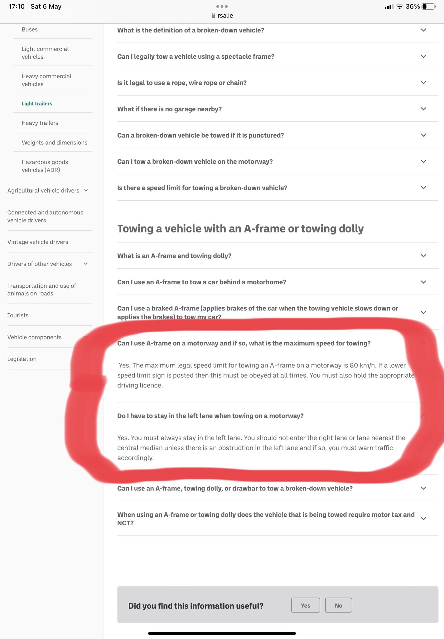

it’s a similar situation in Ireland except that on motorways, they can only use the nearside lane (barring obstructions).
..., they can only use the nearside lane (barring obstructions).
They can't used the right hand lane if the motorway has three or more lanes; so the first and second lanes can be used unless otherwise signed.
See this from the FAQ’s on the rsa.ie website..
