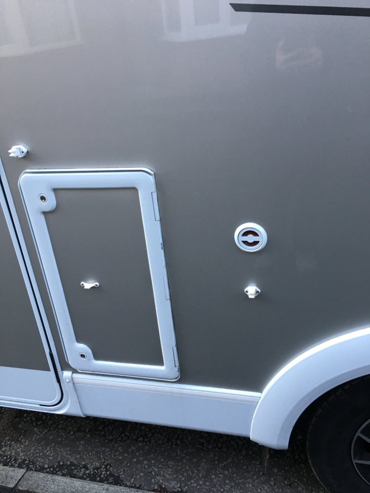

There is a train of thought that having the filler fitted so that the inside of it goes into the main habitation area (albeit in a cupboard) is a no-no ... the reason being that if you are filling it and the internal nut is loose, or there is a leak there, your MH 'could' have high pressure gas pushed into it which would be very dangerous, its certainly something I would avoid doing at all costs.The larger pipe is from the external filling point, through the wall of the cupboard and into the gas locker from where it is linked to the filling points on each tank.

There are 2 pipes visible under the regulator. The thin one is original fitment, it goes straight down to the floor and into the cupboard behind it then across the MH to isolation taps. The larger pipe is from the external filling point, through the wall of the cupboard and into the gas locker from where it is linked to the filling points on each tank.

That pipe isn't going through a part of the inside of the van is it?
I think your meant to keep all the gas hoses either inside the gas locker or outside the van. Should that connection leak you'll be filling inside of van with gas .especially at the filler point
Yep I just commented on that too.
Not a good idea to have the filler there. Fitted to locker door or skirt panel is a better option
All the internal pipework is very low pressure, normally 30mbar from memory. The supply from the bottle to the regulator is at much higher pressure, and the supply from the filling point to the gas bottles is even higher pressure. Normally high pressure gas pipes are not installed in the habitation area.If you are supposed to keep all the pipework in the locker or outside the van how are you going to get gas to your oven, fridge, hob and heating? .
The pipes going to your appliances are metal not rubber and sealed differently from the filler pipe to inlet.If you are supposed to keep all the pipework in the locker or outside the van how are you going to get gas to your oven, fridge, hob and heating? If you scroll and look at subsequent posts you will see the fill point is in fact enclosed in an airtight box with its own drop vent, isolating the fill point and connections from the habitation area. I didn't see much point in posting a picture of a box, it tells the viewer nothing.

Like I said it's your vanAnd pipes from the tank(s) to the Reg and Reg yo appliances are pressurised all the time and able to leak the contents of the whole tank into the habitation area. The fill pipe is isolated from the tank
once filling is complete, so worst case scenario is that it develops a leak an the contents of a whole 600mm pipe drop through the floor?
