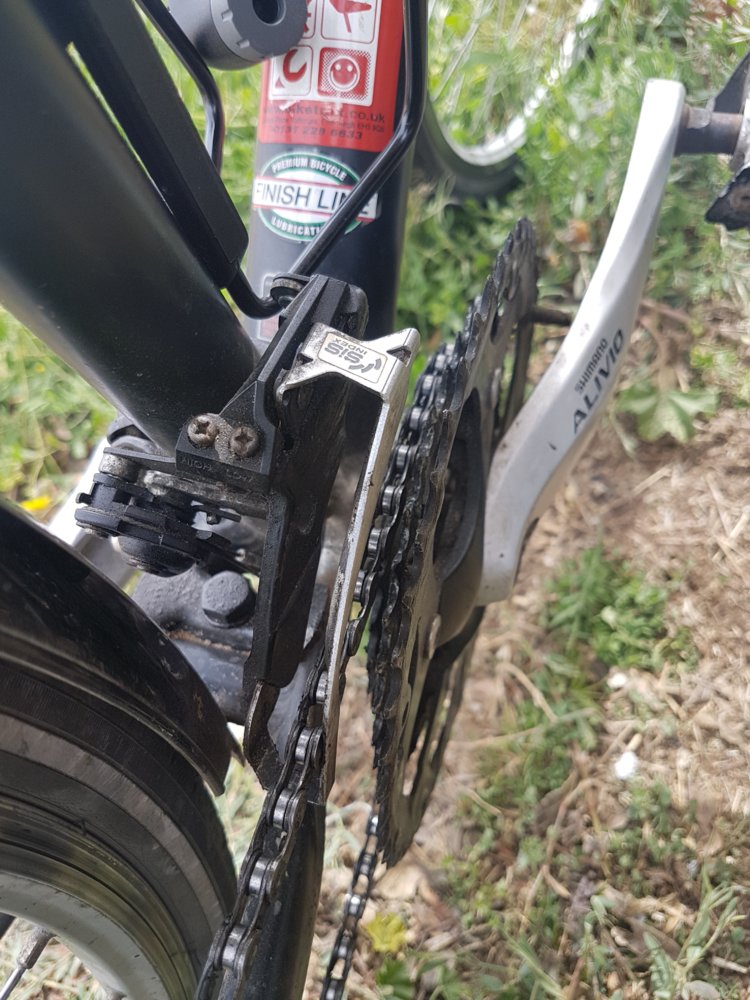

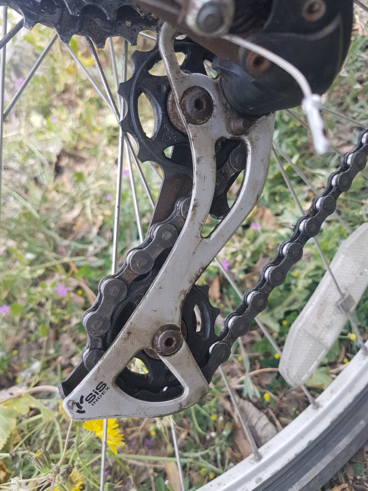

Also what about the small cog on the gear shifter - are the teeth on it OK or is it bent or distorted - again the breaking of the chain could have caused damage to it
Yes that's where I'm thinking the problem lies but it's hard to tell as I never paid much attention to it before.
I'll take a few pics of it shortly
Here's a few pics ...dont know if they will help.
Hate when I can't fix things or solve the problem and I'm hating not being able to use the damm thing.
Hi Tam it looks like your derailier is not forward enough to me so the chain is not wrapping around the rear gear enough.
Hate when I can't fix things or solve the problem and I'm hating not being able to use the damm thing. View attachment 222607 View attachment 222608 View attachment 222609 View attachment 222610
Have you indexed the gears since replacing the chain link, lots of vids on you tube showing how.
It looks to me as if the body of the derailleur has been twisted but it may be that is how it is meant to be, it takes a fair amount of force to snap a chain and something could have bent in the process.
@Northernraider the deraileur unit is too far back its been twisted rearwards loosen the shiny socket head screw and rotate the whole unit anti clock so that it sits under the cog set , and wraps round the cogs more :)
It looks to me as the body of the derailleur has been twisted but it may be that is how it is meant to be, it takes a fair amount of force to snap a chain and something could have bent in the process.
Jees I don't even know what that is lol.. I just joined the chain and thought it would be fine.
Admittedly these days I've not a clue with bikes unless they have engines.
I stripped the derailuer off the bike earlier and cleaned and loosened everything off, it seems to be a little better now but still does it occasionally under strain ie going up a hill.
Guy in decathlon didn't have a clue.
The derailuer does seem to sit very far back and you can move it where it attached to the frame which I'm not sure if that's supposed to do that or not.
It does seem to be a little better now I've cleaned it and sprayed all the parts with wd40...maybe something is sticking it's hard to see when pedalling it and it doesn't do it unless under strain so I'm baffled.
Worse case scenario I'll have one of the bike shops in totana check it out tomorrow
I did that but it seems to just move back
It only sits forward when it's on the biggest front cog ...otherwise it seems to tuck in under the rear cog

When you replaced the chain links did you take the same amount off as you put on...? The chain could be too long..?
It's not that difficult, even I managed it following the you tube clips, just involves slackening the cables, adjusting the stops that limit the travel and then getting the correct tension on the cable.....simples:)
Another vote for the chain being too long or slack.
Difficult to describe in text ..even explaining it to the guy in decathlon was difficult.
You really need to ride the bike to feel what it's doing and then I really need to compare the movement on my derailer to someone else's bike because I'm not sure if it's supposed to move at one of the parts that is moving.
Where it attaches to the frame via the centre bolt the body of the derailer can move almost 90 degrees.

Possibly stretched other links when under the tension needed to snap one of the links, were you changing gear under load when it snapped?
Yes I was trying to get up a steep hill left it too late to change down gear stood up to pedal and snap ....it broke
Just been watching one of those videos on YouTube...he does make it sound easy
And one of those stands would certainly help.

They certainly make it a lot easier, I have used one of the tow bar mounted v shape bike racks to do it in the past.
My dad gave me a good tip for checking when a chain is knackered, when it is off turn it on its side and hold it out, it should not bend too much, if it bends through 90 degrees it is well gone.
A better way with an explanation
https://cyclingtips.com/2016/09/how-to-check-for-chain-wear-2/
@Northernraider
Look at this pic , this shows you the position your changer should be in with the pantograph carrier almost horizontal , so the chain is wrapped round the cogs , otherwise the chain will slip :)
@Northernraider
See mine won't stay in that position, with it only having one central bolt attaching it the the bike frame it's free to move regardless of how much I tighten it.
