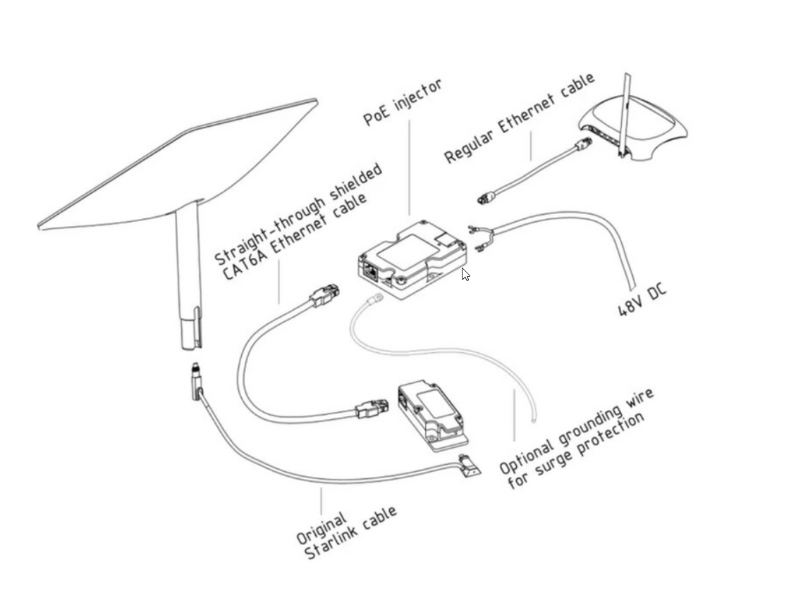

thanks, but they need to be three pins from the router to the '12/48v supply' - 12v, 48v, gnd

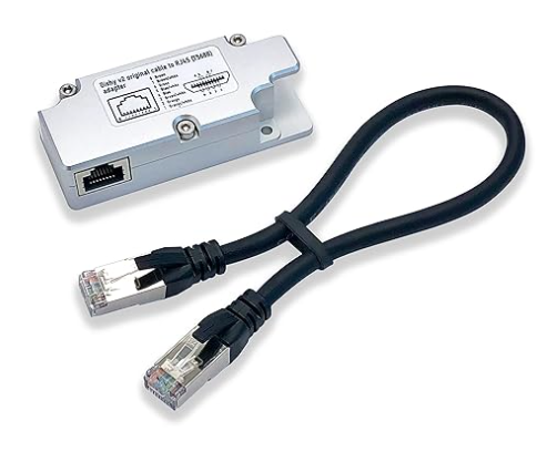

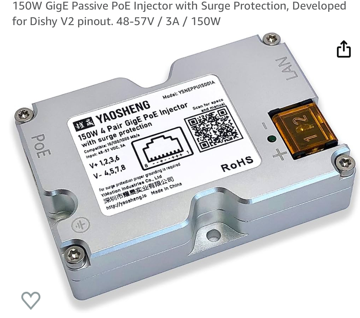

I have 2 pairs of yaosheng adapters coming hopefully by the end of this week.
This consists of the dishy adapter posted earlier in this thread where it saves you cutting the dishy lead and also the 150w adapter to power the dishy. All that is then needed is a cheap 12v-48v convertor from for instance amazon to then make the whole thing work on 12v
You will of course need a 12v router as well
Any one interested let me knew as there will not be anymore of these moving forward and they will be sold at cost plus postage also at cost.
Photos attached, this also means no cutting the dishy cable and wiring special network cables as this will use standard network cables.
The best solution is the dishy duolie but these are nearly impossible to get hold of without waiting months and months.
I wanted something so I could convert it before we leave 7 Dec for a few weeks and unfortunately the dishy duolie is never going to arrive before this date.
