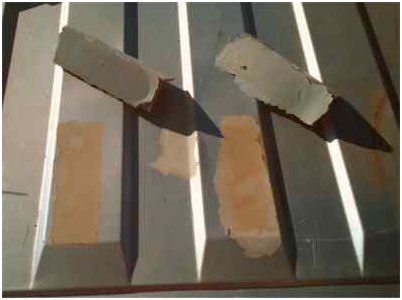

I found this on another forum a while back. It is a photo of a Fiat roof where the adhesive didn't fail but the paint came off the vehicle. Another argument for using screws or other mechanical fixing.
we don't know what adhesive was used.. and clearly a bodge job
but in any case, clearly the preparation was poor.. or non existent, you can't bond onto paint, should have been sanded down to remove the paint. as per SIKA INSTRUCTIONS
with correct preparation, (as posted) and using SIKA 252 + Akitvator, it will never come off

The panels were fitted by me 13 months ago using Silkaflex 521. Both surfaces were well cleaned and keyed before fixing. The Silkaflex has parted from the plastic feet as a good amount of approx 6mm high Silkaflex remains on the GRP roof of the van.
