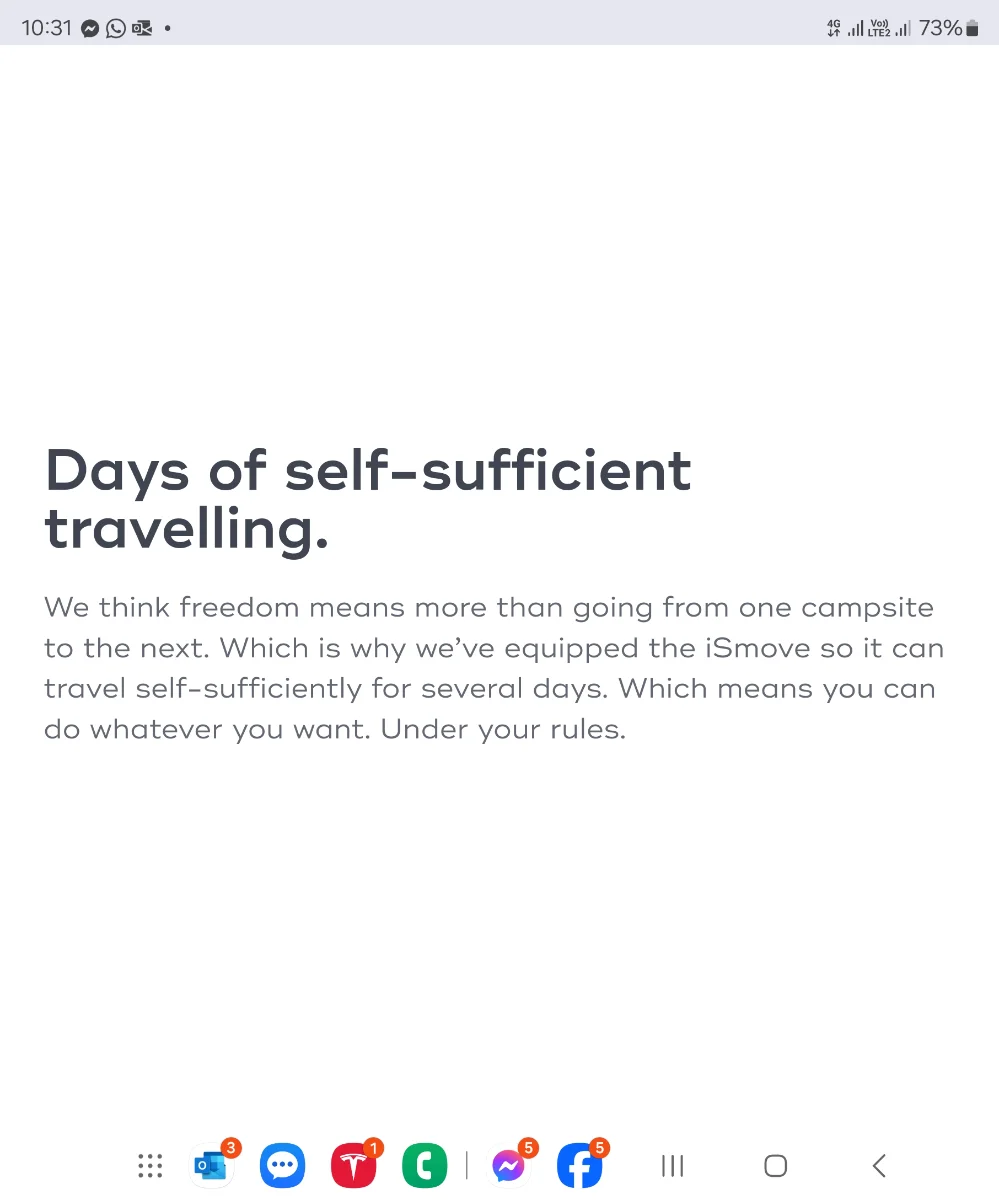

Where is this dodgy marketing that is better than reality? If it's out there, point it out so we can call them out (y)
Ok here you go, straight out the Niesman Brochure, checkable on their website.
A claim that is nonsense... it should have an asterix and a bold highlight reading...
When we say your way, we mean providing you are not in the UK in winter and you have a wife with hair.
There are loads of false promises out there. Glad I wasn't taken in by it.
If companies are saying "you can live a life without ever worrying about shore power" then this is clearly only true if you live within your means and budget your power use accordingly. There are many vanlife exponents online who do just that, so it is perfectly possible.

this is a factory fitted system from one of the very best motorhoming manufacturers in the world (allegedly). Your response is pretty much nail on the head...
The advert says "never have to worry about shore power again"

So if you go back to my first post, my night at Stratford upon Avon cost me 40 percent of my battery power. 2 nights I would have been done practically..
As Carpmart says, the expectations of people need to be controlled. I've heard sellers selling, I've seen posts on here saying they are "grid free" living.... well here's a thing, if they had my wife living with them they would be towing a Tesla Power wall
Even when buying this vehicle, the seller was telling me you can live forever off grid, she had never.had.more than a few nights away from a campsite. But the salesman told her.
