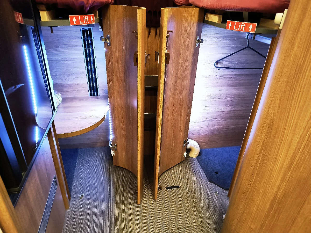

First job was get rid of the crap lights.
Then I fitted a fuse box under the floor and tapped into the Carthago loom picking up the feed to the Hella socket at the front of the van.
Quite a nice box that had a negative buss bar quality looks good, will be wiring my electric waste to it as well. It came with a bag of 25 blade fuses usual Chinese crap so they went straight in the bin.
And the final result, LED strips switched with magnetic door switches.

Looks about as bright as an operating theatre in those cupboards. I like it! :)

Agreed these are a great improvement, but I must be easily pleased, as I am happy with my little crappie lights . 😃 😊
No seriously, I had 12v lights in some of the cupboards in my 2009 autotrail, I was surprised to see a battery powered light in the Carthago. Mega impressed with the rest of it though.

Looks great Lenny HB which lights did you use?
