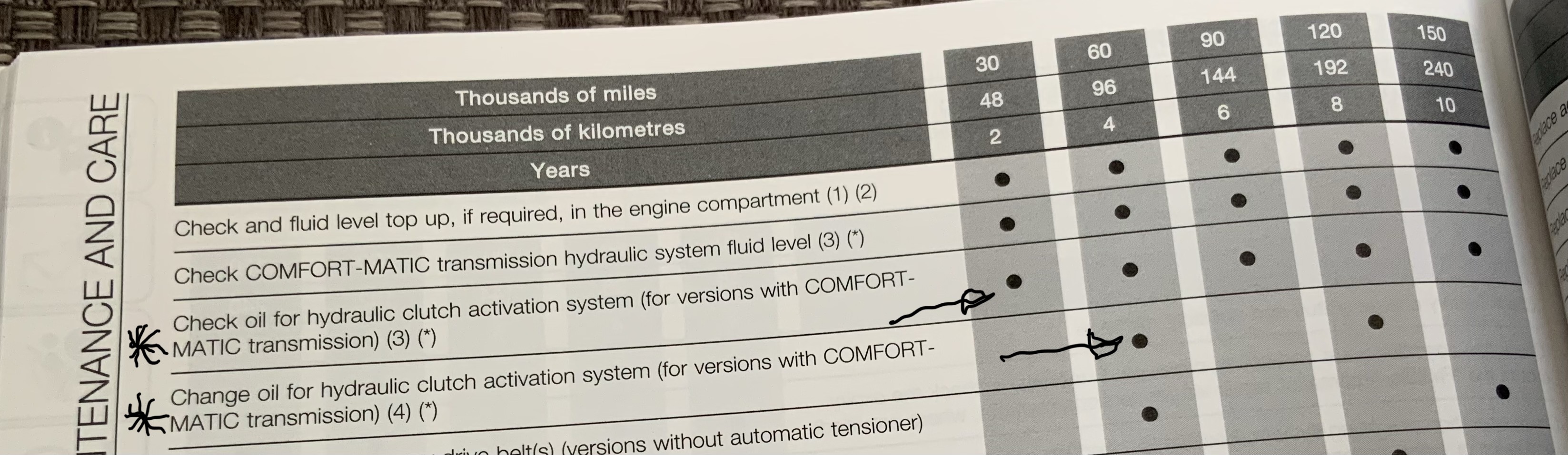

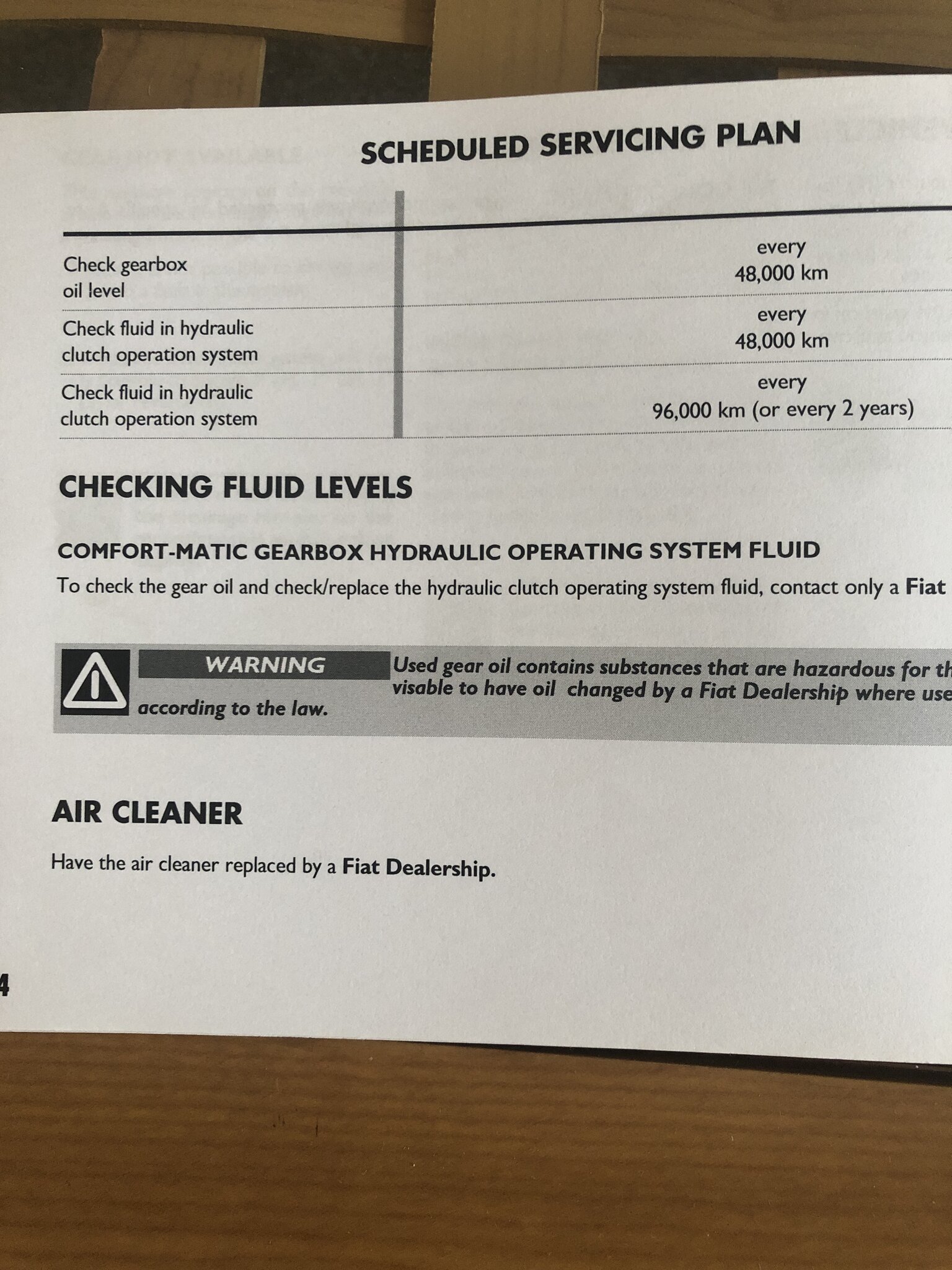

Maybe we need a list of competent people/garages to do the fluid check/changeSo latest update is that the clutch and cylinder have failed, but flywheel is OK.
That the cylinder is a problem will relate to the Comfortmatic hydraulic fluids for the robotisation. Shows how vital it is to get these Comfortmatic fluids checked / changed, which is buried in the Fiat manual's service notes, but I can find no reference that it was included in the 3 year annual service plan provided by my motorhome dealer from new.
