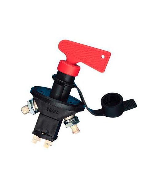

For those who are worried about cutting power off in an emergency one of these FIA Jobs would do the trick no cutting of cables, just a simple twist, all track cars have them.
needed.View attachment 583751
Have one fitted on my engine batt negative .
Good anti theft and prevents batt drain
I have one of these big red cut off switches in the HAB battery compartment on my Carthago C Line which I believe is a Carthago Factory fit, I also have one next to the inverter which I don’t think is factory fit, BIG question….. does the factory one kill ALL the 12v hab electrics
Mine does Ady
