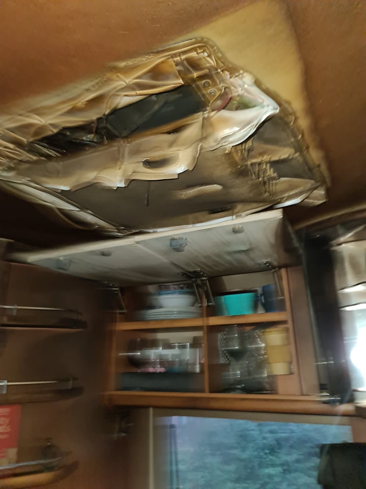

So today, was the day we sort of dreaded. Our chance to get in the motorhome and see what was or was not salvageable. Pretty much nothing. Not a thing came out of that motorhome that was any good. 20 years of our motorhoming life just laid bare in front of us. Things that we had from the beginning to now, special shot glasses of places we had seen and been. Things that meant nothing to anyone but everything to us. I truly empathise with anyone that has had a house fire. It must be the most awful thing in the world to lose all your possessions. The worse loss is the little wooden plaque the lady who gave us our first Newfoundland dog made for us when she passed away 2 years ago this week. Knowing how much Tara loved to travel with us, she made it and gave it to us so that she could continue to come with us on our journey. Thank you to dulvil for sharing your experience, i was beginning to think we were the only people this had ever happened to.
I took some photos of the damage to share. I know some people say you should be careful sharing these things as insurers monitor the internet but I have nothing to hide, only advice to say to others, check your smoke alarms, regularly at home and in the van.
So today I rang the insurers, quite frankly, they showed no empathy, literally took my details and said a claims assessor will be in touch. I then had a text from a claims investigator telling me that they would be posting yes posting our my claim forms and then they would be in touch when they received them. In this day and age they post them apparently. They are coming to collect the van on Wednesday and thats where we are with it right now.
so here's some pics, and thank you again everyone.

Looks a bit of a mess. So have you any idea what caused the fire Paul?
Ken check out Paul's post 174 he has explained it on there.

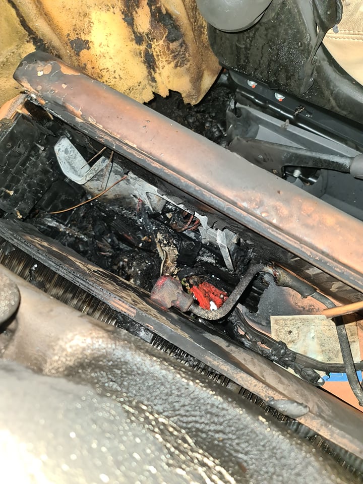

We never slept a wink all night tossing and turning wondering what happened what went wrong and why us. I know a few people have asked and keep asking, "what happened". We genuinely have no idea, we had a great night away in Preston, a night near home in Northwich, one on electric, one not on electric. All seemed fine, the van drove beutifully and there was no indication of anything being wrong. When we arrived home, we done what we had done 100 times before, got in it to clean it and I done the outside lockers. As the van was new I looked in the lockers a little more as you do looking for space of where things may or may not go for upcoming trips.
When looking in the locker with the electrics in I could hear what I thought was Arcing, and Nikki shouted from inside she could smell smoke, she dashed out the van, by this time a fire under the drivers seat area had really taken hold. I utilized my fire extinguisher and my neighbors came over with theirs but there use was futile.
I dashed around trying to take out things like the gaslow and disconnect the batteries to prevent any explosion whilst Nikki called the fire brigade, I then spent time burning my fingers as I tried to rescue a few personal items again to no avail as the fire had really taken hold. The fire brigade were excellent and were in attendance within 6 minuets and took over. They were initially very concerned due to the high level of flames and heat as well as the risk of explosion from gas and a full tank of diesel on board. They spent over 2.5 hours on the van dousing it out but it kept coming "live" again. eventually they realized the fire had spread above the cab bed and didn't know there was a drop down bed up there. It then fell down and revealed a fire still up there which they put out. They simply stated that it was an electrical fire.

Was it on EHU at the time? Not clear from the post. Quite worrying either way. For it to be arcing it would seem it would have had to be on EHU? You wouldn't get arcing from a 12v system? Unless there was an inverter in the way somewhere? Interested to know.
A short on a 12 v battery wiring will take seconds to melt/ set fire🔥😳 No inverter needed. If on ehu and shorted out then the RCD would have tripped stopping the power
It was fitted from new by brown hills who said they subbed it to transleisure.
It had a clamp which must have come slack but no fixing to stop it going sideways
