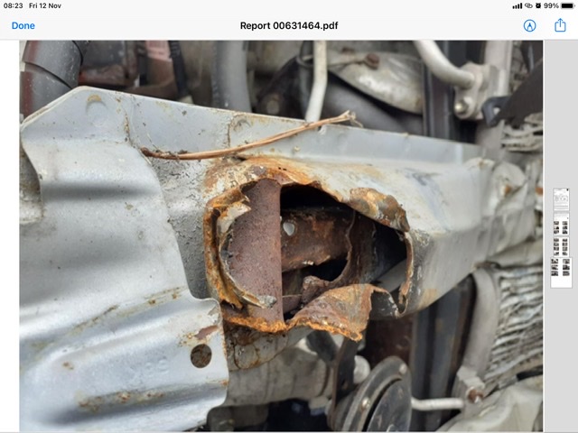

The disaster of which he NOW claims had "Pedestrians running for there lives" his words not mine was the result of.
1. Poor design
2. Poor installation practices
3. Incomplete installation
The likes i have never seen before or since.

4. Lack of maintenance which appears to be the case in this instance.
I agree completely Geo .. only I reckon you should add to your list .....
Your not wrong BUT
What failed was a really crap choice of metal to weld too.
Welding to that thickness of steel immediately causes a weak spot its self
had something been bolted instead it may have survived, its all speculation
An inspection may have spotted cracks sooner, but when how often
its quite a job to get to see the inner workings on some cars

Following a recent catastrophic failure of an a-frame towed car I have, this week, formally called upon Trading Standards and the Vehicle Safety Branch (VSB) of the Driver and Vehicle Standards Agency (DVSA) to implement a PRODUCT RECALL on specific a-frame installations.”
From fb; Tony Maris
Product Recall.
The towed car suffered a sudden and unpredictable failure of the a-frame to car interface, apparently caused by a combination of poor welding, lack of corrosion protection and various stresses imposed, but CRUCIALLY, it should have had an emergency breakaway system installed in accordance with the Road Vehicles (construction & use) regulations 1986 [and amendments] and COMMISSION DIRECTIVE 98/12/EC.
The object of the emergency breakaway system is to stop the ‘trailer’ in it’s tracks and prevent the ‘trailer’ literally breaking away and going wherever, in this case mounting a pavement and scattering pedestrians.
The number of vehicles affected is currently unknown but if your vehicle is one, a simple visual inspection will identify it.
Do NOT rely on any written statements like “Automatically sets itself up” or “Break-away safety features built in”. Without the ring highlighted, it has no emergency braking in place!
The product is from a company known as Towbars2Towcars, Grimsby. Their standard practice would be to install the emergency breakaway facility, identifiable by a ring ‘mini-cable-tied’ to the vehicles front grill, adjacent to the 13 pin electrical socket.
The ring is for the attachment of a supplied, breakaway cable. SEE PHOTO.
if your vehicle was converted by this company and is lacking the ring, it is ESSENTIAL that your car is drawn to their attention with a view to being modified.
Failure to act is putting LIVES AT RISK!

Any repercussions for the company are entirely down to their own failure.
Luckily, no one was killed or even injured, but it could have been so different.
Have a look at the attached. Is this your idea of ‘engineering prowess’?
