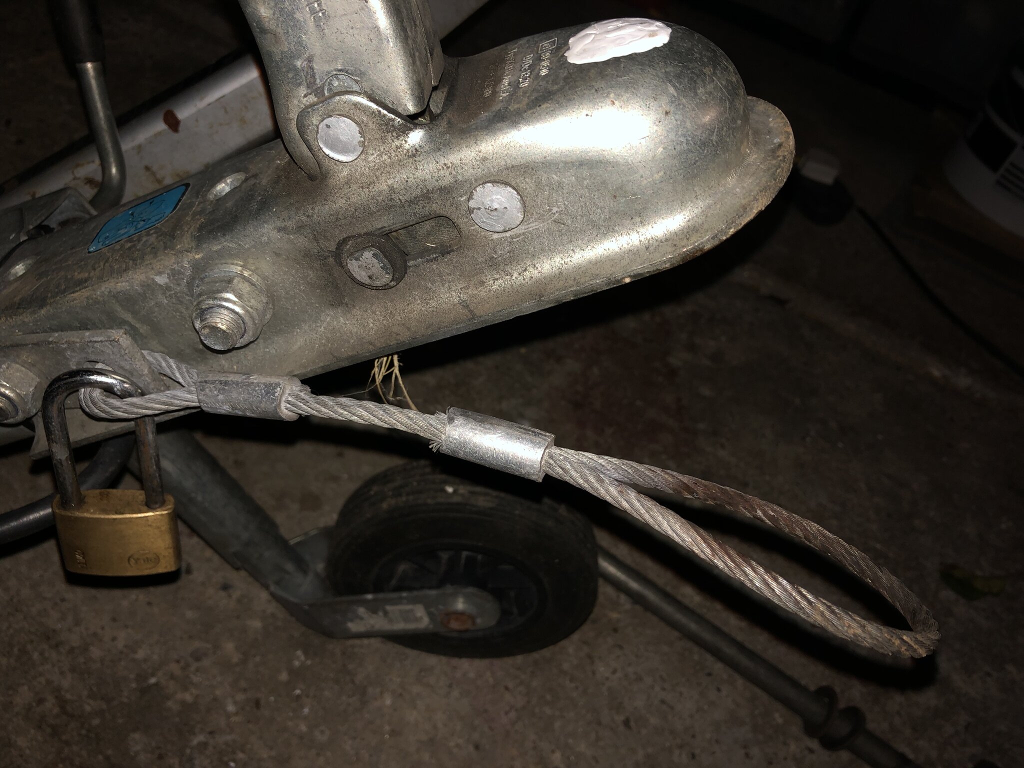

It is not the breakaway cable looped over, it is a secondary Bowden cable loop as an extra safety precaution. The breakaway cable is separate and links between the rear of the motorhome and the power switch on the front of the car.
So what does this secondary cable do .
What is it's diameter

Been into the garage , photos as promised, the cable was fitted as standard by Towtal.
Thoughtful but ashame it's not long enough to attach to tow-bar frame or chassis.
Being just long enough to drop over the towball if there were a problem with the hitch it would stay close. OK it’s an extra that Towtal fit so I use it, belt and braces maybe.
It has inspired me to fit twin safety chains long enough to reach towbar. The fit similar to unbraked trailers which also hsve a skid immediately behind hitch to prevent hitch for digging into road if detached

Lenny secondary cable is ideal as described and fitted BUT that is most definitely NOT the place to use as a main breakaway point
All the extra cables and chains suggested here would not have helped if the frame detachment happens at the car end.
