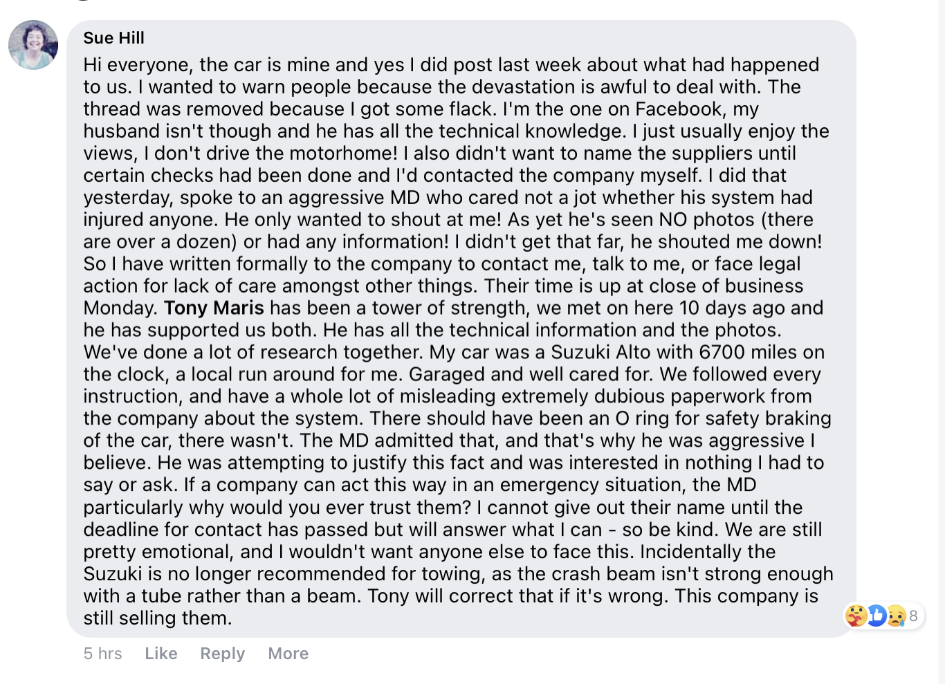

The original post was mine, on a private Facebook group.
while I’m keen to spread the word about towing safety (it is after all, a 30 year campaign of mine) now is not the time to say too much.
The owner is trying to open a line of communication with the original supplier of (brand new) car and a-frame. Currently, all they have received is a tirade of abuse over the phone. They have another opportunity. If that’s not taken, then the discussion may able to open up.
I note from some of the posts, folk are referring to the breakaway cable as if it were an inertia braked trailer. It wasn’t. This was an electronic braked a -frame.
Even with a catastrophic Incident like this, there should have been emergency braking to at least stop the car, there wasn’t. This was not user error.
Hopefully, I shall be able to discuss it further in due course.
I would appreciate if any speculation is kept to yourselves for now. Give the owners of the vehicle a chance to have a meaningful conversation with the company,
Thanks Guys!

I didn’t post it, it was a screenshot by someone else of a post in a private Facebook group! What I’m asking for now is that time is given for the user to try and settle things with the suppliers!
BTW, if you think this is scaremongering, then think again. Have some empathy for the unfortunate users…

Three thoughts. The corrosion is pretty much only where the fixings went through so they’ve probably drilled holes and then not protected the holes. It’s been failing for a while, so hasn’t been checked on. Also these systems are dangerous and should not be allowed.

If the installer didn’t provide a breakaway cable sounds to me like he is not competent enough to install an Aframe at all.

How would a breakaway cable help if it is attached to the A frame still dangling on the back of the motorhome? Most are designed to operate when the frame separates from the towing vehicle not when the frame separates from the trailer/car.

So far I have found that some cars are not suitable to be "A Framed" unless they are modified which may impact on the CoC. Some A frame suppliers / installers are doing a dangerous modification and that there are lots of opinions on A frames.
If the cable is attached to the a-frame then even when the a-frame leaves the car wouldn't the cable still be attached to the car in some way and thus be pulled tight? If not it wouldn't be able to put the brakes on anyway. Not had an a-frame so not sure how the brakes are applied on the car.
Wife's Suzuki Alto with the A frame attachment bolted to the chassis on either side, made by me, its 3mm box section steel.
The hole on the right which I assume they used as a mounting point, wasn't in my opinion be suitable for an A frame attachment point and it appears I was right.
The original cross member its pressed steel probably 1mm thick or less
The new cross member 100x50x3mm
What year is this one please? It’s interesting as a comparison!
Maybe they did but was not fitted to the car
Here we go! That’s pure speculation which is why I’ve asked Jim to take the thread down for now. I’ll update when the owner has had a meaningful conversation with the suppliers.
For info, it WAS attached to the Motorhome, it was NOT attached to the car. The supplier never provided an attachment point. This was NOT user error.
