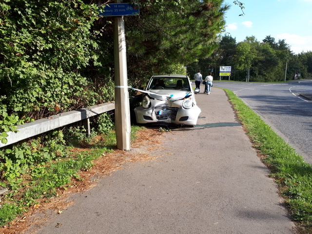

TonyEmm
If you look at where the A frame broke away from the crossmember there is very little 'fresh' metal - most is rusted.
To blame the installer 10 years later is in my opinion not just unreasonable but idiotic.
The installation has clearly never been inspected or checked.
If anything this sort of posting will alert owners to get theirs checked.
As for statistics Insurance Companies will have data on all claims.
If there was a serious basis for his scaremongering eg accidents , injuries , deaths then no problem with me but Mr Emms does not even quote a problem he has had in fact he probably has never used one in which case anything he states is probably unfounded and unhelpful to the many motorhomers that safely and not illegally enjoy an extension of the Fun of motorhoming.
I think the A-frame less car hitting the lamp post is an accident so that IS a serious basis, not for scaremongering, but bringing to people's attention the issue, which possibly rare, doesn't mean it hasn't happened before, nor that it has the potential to happen if there is a 'fault' with the installation, either through it being incorrectly done, not maintained, checked etc.
There are a lot who do A-frame vehicles and they IMV need to know to check their installation regularly as I suspect many do not and instead assume their garage (either at service or MOT time) will do so who won't as it's not part of what they do unless requested, or the owner doesn't bother at all as it never crosses their mind, just as those who have a towbar fitted, other than checking lights on what they are towing, won't give any thought to how well the tow bar is fitted, whether it has rust/corrosion at the attachment points, whether it needs maintenance etc.
If reading this thread prevents ONE instance of an A-framed car detaching, or becoming unsafe, because an owner decides to check it, it is a good thing, there's nothing wrong with that at all. As for A-framing itself, that is up to each person to decide if they want to do it, personally I wouldn't but that doesn't mean I would stop others from doing so by saying it is illegal as it isn't that clear cut, however I would advise them to ensure it is safe to use (ie maintenance etc wise).

I don't think it's that clear cut, the installation was done incorrectly from the start by the look of it and would, at some point, fail. The car hadn't done a lot of mileage (assuming it recorded it when towed) so if it had been A-framed more extensively, as many do, it could have failed sooner. Yes there is rust etc but that doesn't negate the fact that the mountings should have been done properly in the first place, if they had been maybe there wouldn't have been anywhere for rust to start forming?
Does everyone who has a tow bar on their vehicle check it is still okay after 11 years? I doubt many do as it's pretty much a 'fit and forget' addition.
You are correct but after 10 years? - but what proof is there that the installation wasn't done properly.
What is certain is that nobody has inspected it until now.
On what basis will an insurance company feel it should pay any claim?

I think we can all understand that in our 'unqualified' eyes using mountings attached to a weak point on the toad vehicle isn't right, whether using towing eye points or not, the attachment site should be more robust than it appears to be.
As for inspection, no idea, how obvious it was prior to this is difficult to say.
Insurance ... that is the big question, they will only pay out once fault has been established, if at all.
