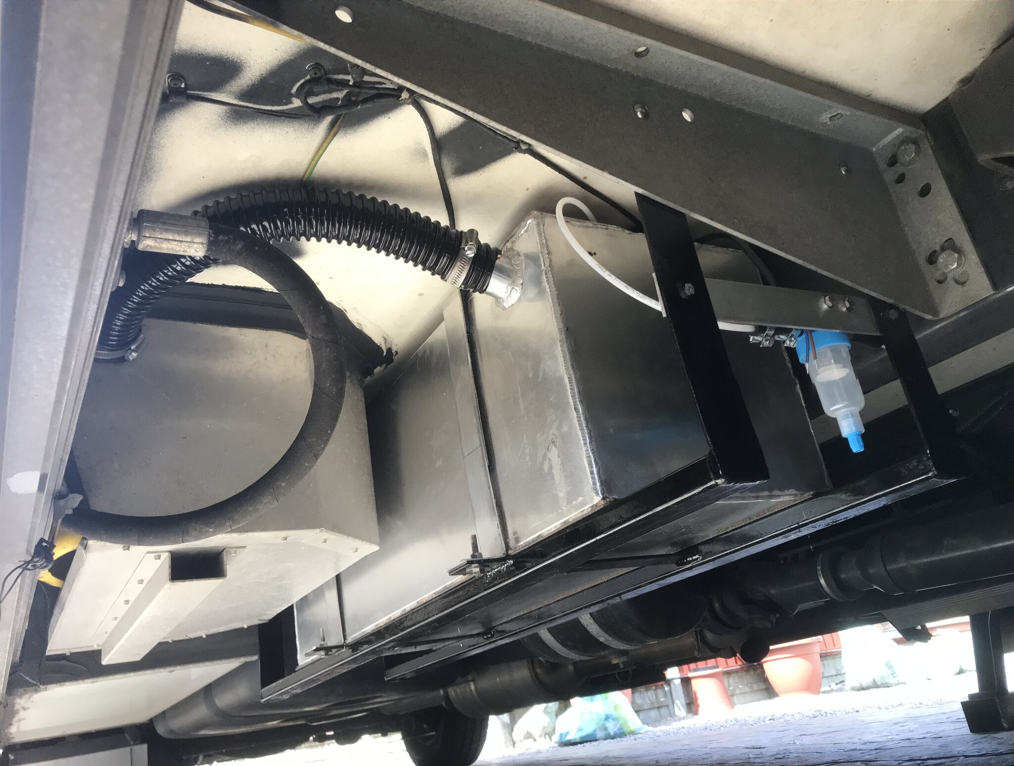

2KW diesel heater installed. Review, performance, sound, cost.

1 Week update.
My 100Ah Lithium battery is down to 77% so it has used 23AH to power it for the week. This is a true figure as the Lithium battery is not connected to anything else and no charger is plugged in and no solar. It is literally a standalone system.
It has used somewhere between 7-8 Litres of Diesel costing me no more than £8 for the week.
Some context. This is in a very poorly insulated caravan parked on the top of a hill in the Lincolnshire wolds. It is only protected from the wind in 2 directions and when the wind blows the wrong way the draft into the caravan is physically detectable across your face/feet. I believe this caravan was only designed for summer use. The reason I mention this is that your motorhome will be better insulated and the figures above should only be used as an indicator. I suspect providing you do something about the cab area you will have better consumption figures.
I am extremely happy with this little 2KW heater and would happily recommend them to anyone.
