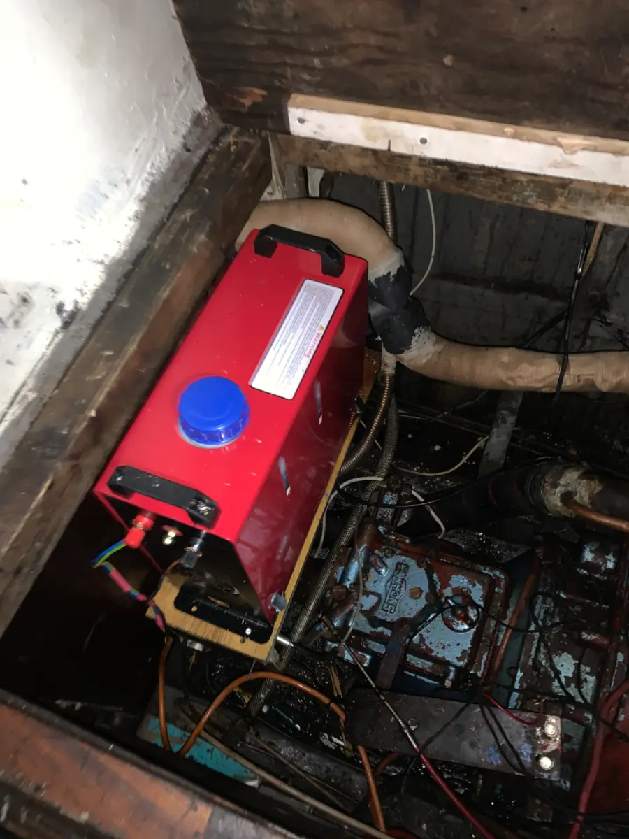

I installed a 2KW diesel heater 2 days ago. Here is my initial review.
I was heading towards the peak winter usage of gas at 1 bottle per week and these are currently costing £42.99 per swap.
In addition my gas heater just doesn't cut it in the winter even on full blast. So a Diesel heater has been long on the cards.
Now I have my industrial unit I could strip stuff down and had places to store all the crap while I did the work and it wasn't so much of a hassle to do.
Soo. The install. I wanted to install it under the bench seat opposite the one I use as a bed. But due to the water heater being in an awkward position this was not possible with the chassis rails.
Moving it is possible but is a future project and I didn't want to do it just now. So. I installed it under my bed as that is the easiest place to get to. Right at the head of the bed.
It wasn't until I started testing it I suddenly thought about having that fan/tick right next to my head whilst trying to sleep and got a bit concerned.
This fear turned out to be unfounded as once the cushions were back on it is actually quieter than the blower in my Truma gas/electric heater.
Noise levels are therefore not an issue at all with the 2Kw heaters at low. And at low it is heating my caravan beautifully. I have had to turn it off once due to it getting too hot in here once, the sun was out and heating the van up.
Then twice I have opened a roof vent with the fan on for 2 minutes each time to knock down the heat a bit at night. Turning it off cools the van too much and then it has to ramp up to get the temp back up again. So letting a little bit of the hot air out works out better.
It is not something you have to do often with the 2KW heater.
