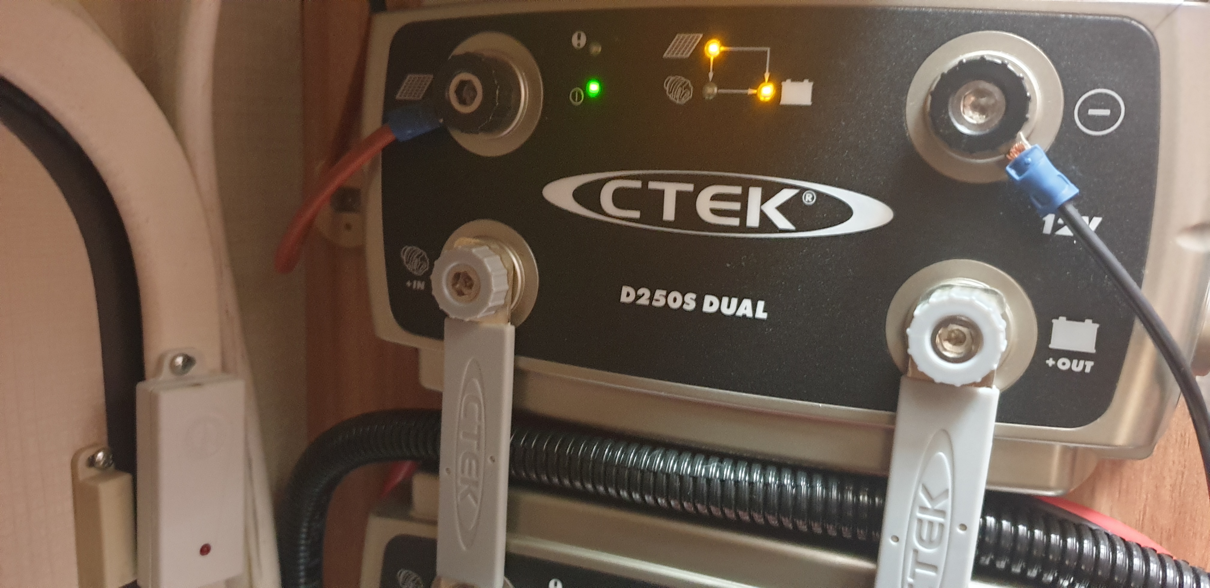

I'm wondering if I've killed them by leaving van on hookup for 3 months over winter (mainly to leave heater on low) or if they've just come to the end of their life - or are they just the wrong type of batteries - stop/start.
Shouldn't have. What charger have you got ?
CTEK system with solar.
Ok I'm home now & got some proper kit 🙂
After being on hookup all night I've tested the one battery & it doesn't look good :whatthe:
This tester puts a 25amp load on.
It lasted 9 minutes before giving up - 5% life in it 😭😭😭
I'm just trying the other one now & then going to put it on a big charger to see if that makes any difference 🤞
That looks like its goosed! The other one will be the same if they have been wired together from new.
