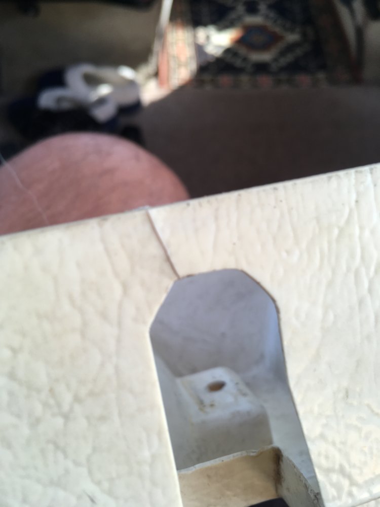

Repaired some cracks in door plastic on my Hymer.
Removed lock surround and glued a piece of ally around area thats cracked and used soldering iron to melt plastic on the back of another crack.
Also another crack near the opening lever, I couldn’t get that part off so I removed the lever surround and glued a strip of ally inside to cover the crack.
