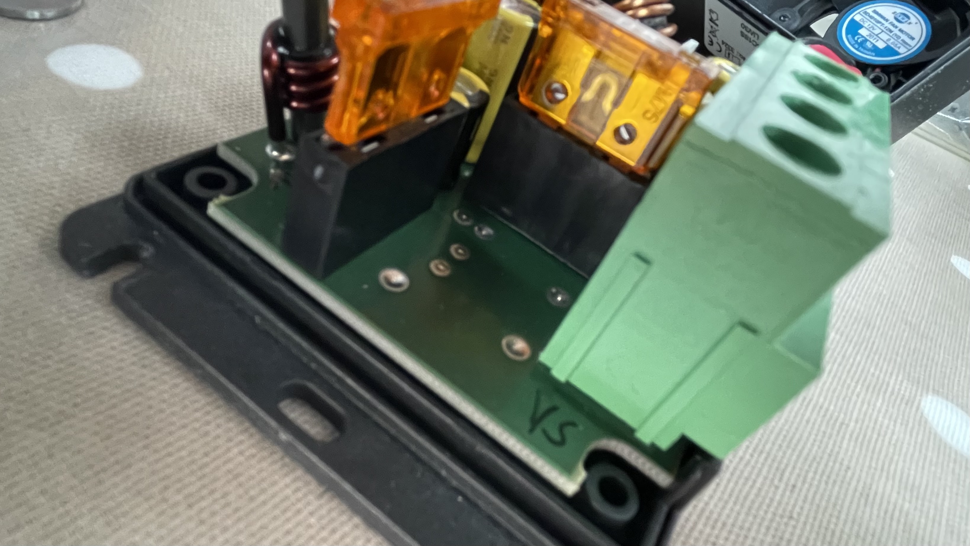

MisterB This is the original one that Votronic swapped out
The serial number started 20V
This is the new one that Votronic sent me to replace the original
The serial number starts 23V
You can see the difference in the fuse position in the first and second one. The fuse in the latest version is much lower down - it’s attached to the PCB. The original one has a black fuse holder so the fuse is much higher up.
Thanks, the info re the serial number is really helpful. I've seen one with the 20V serial number and messaged Votronic, hopefully they will offer to exchange it, I just want to make sure that the seller hasn't already had a replacement issued and is selling the old one !!
