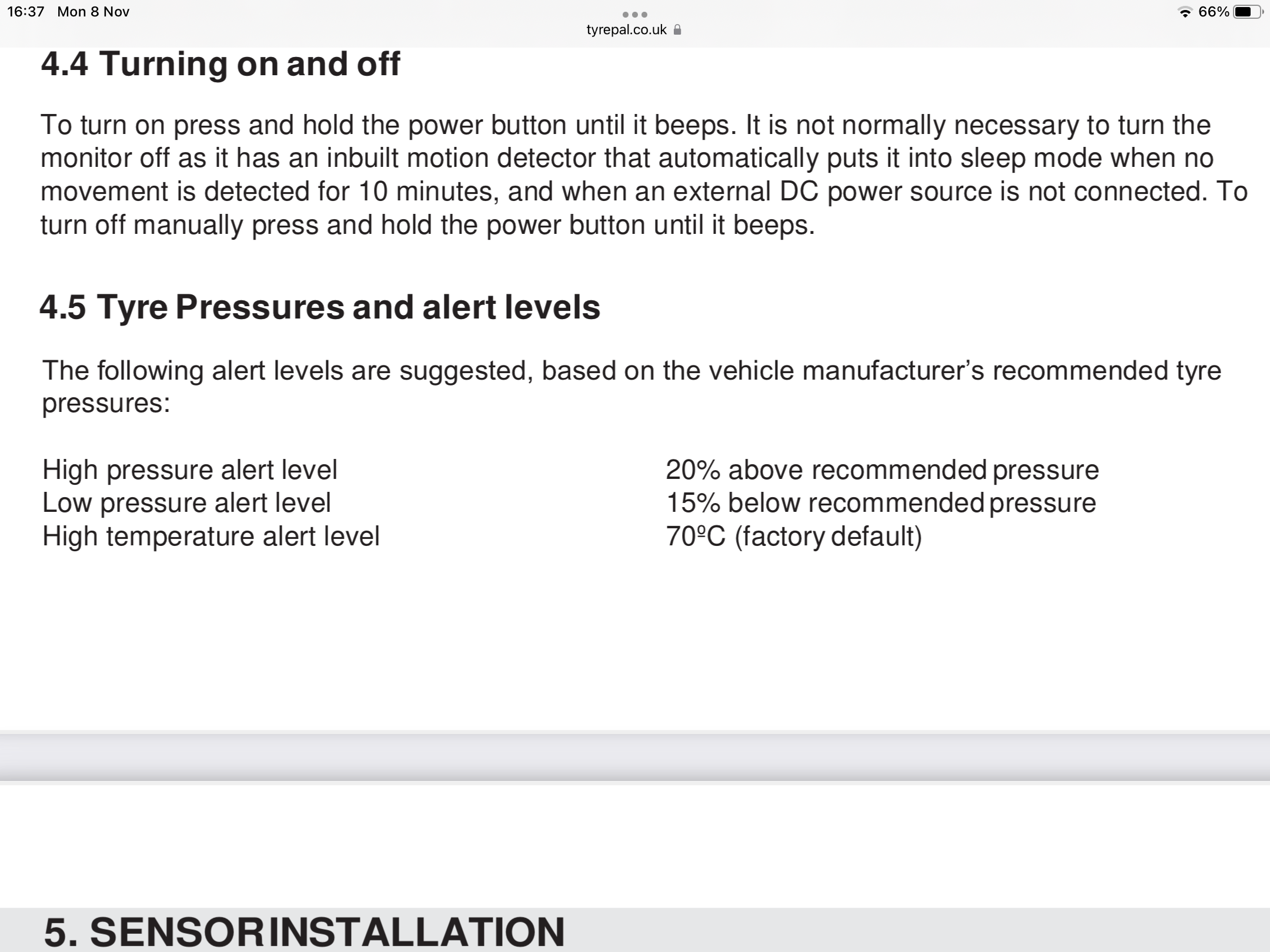

It’s not designed to stay on the dash indefinitely, and should be turned off and removed from the dash when not in use……apparently. My instruction manual stated that anyway. (y)
Been happy with mine for 3 years (apart from spending £25 for my spare wheel, now that is 25 quids worth of peace of mind ). Only problem i had was setting high limmit high enough to stop one rear wheel alarm when hot (Otter Spotter what temperature (increase) is acceptable/normal in UK)
One other problem was one sensor didnt work for over a year because some lazy B didnt change the battery.
Not sure I ended up setting it at 10% over but even on a motorway in Summer it has been known to slip over that.
I did ask Continental but on that one they would comment.
From my manual……maybe try the recommended 20%? That’s what I’ve done and system seems to stay consistent. (y)
