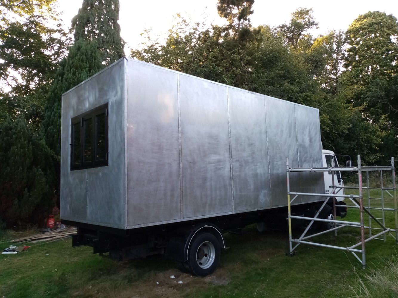

Some overdue updates of the truck
Fully preped for paint (and to anyone that spots the massive blunder... I know.... Im over it... Its to help mpg ?)
Finnaly built a door and finished it, complete with two dead bolts and a latch. Just a but of fiddling with the hinges to get the gap right.
Thank F*** for that, I was getting sick of climate change deniers :D
Getting there then... any more..
What about layout, what have you scribbled down for that or have you done a full on 3D model of the interior :D
Still no idea what the "blunder is"
Yes we have a rough plan. Raised floor at, the front, storage underneath, water-tanks under aswell. U shaped Kitchen on the raised floor, tanks go under he cupboards. Bathroom to the right of the door. At the back, sofa on one side so we can see out the window, then opposite sofa a big wall storage cupboard unit thing for clothes and the rest, cut out in the middle of the unit for the tele (obviously). Bed is at the back above the window on a pully/rail/hand winch contraption thingy (or as jasmine called it "a hinch") that drops down to just above the sofa so we can see out the window again. Then in the middle more stuff and things ?‍♂️
