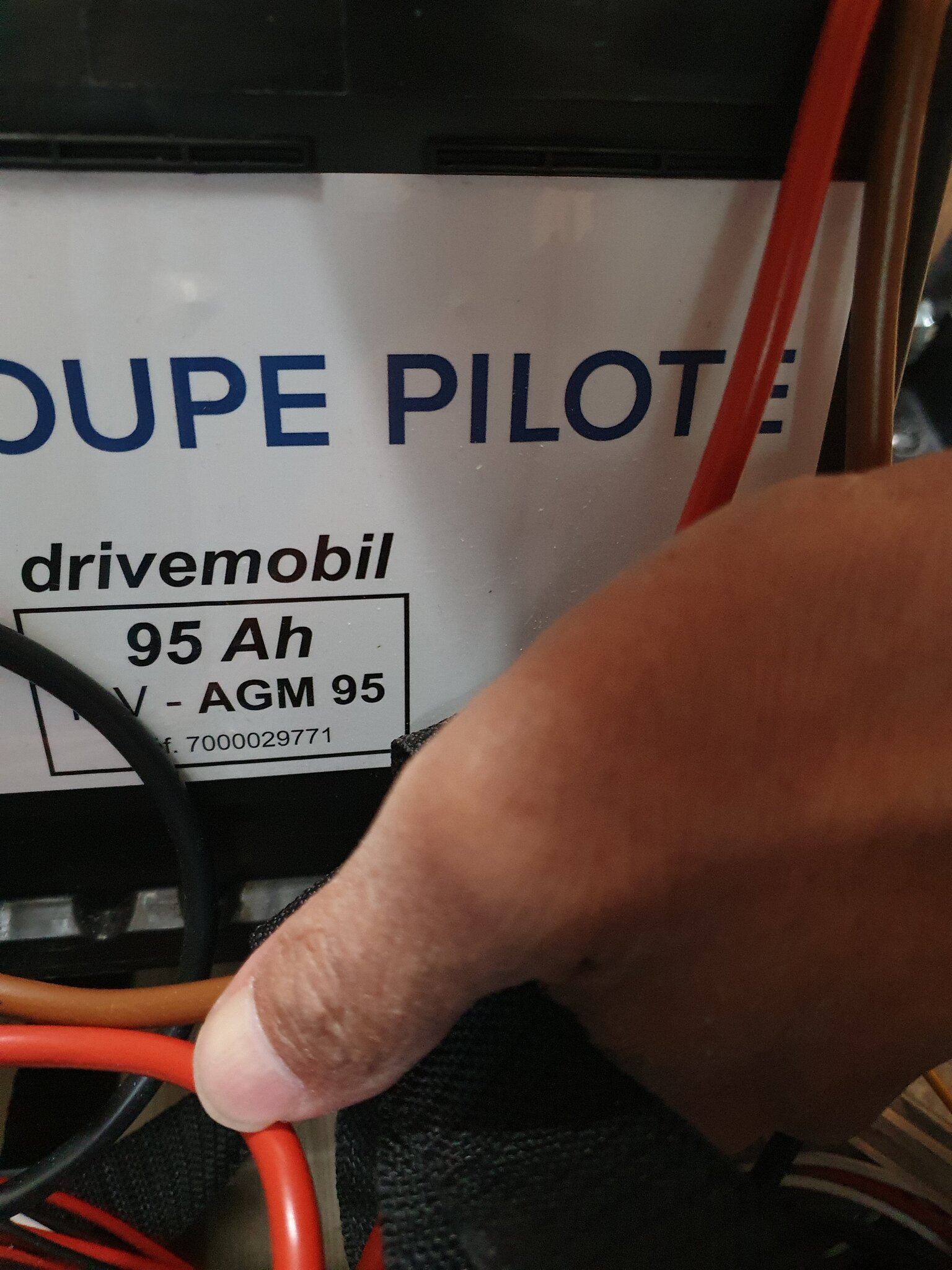

hi suavecarve piccy of battery best shot I can get due to location,solar is 100watt tell me what you think , the more advice I get the better ta.
What do you use electricity for ?
Light (12 volt presumably)
TV (240 or 12 volts) and how many hours a day
Presuming not for fridge as that wont last long
Charging phones laptops ? how many how often
How long do you stay in one place before doing how many miles to the next stop ?
Do you have solar and if so how much - 100 watts just noticed
Do you use motorhome in UK in winter or just in summer - just noticed youre concerned about April in France - Whereabouts in France and how long ?
