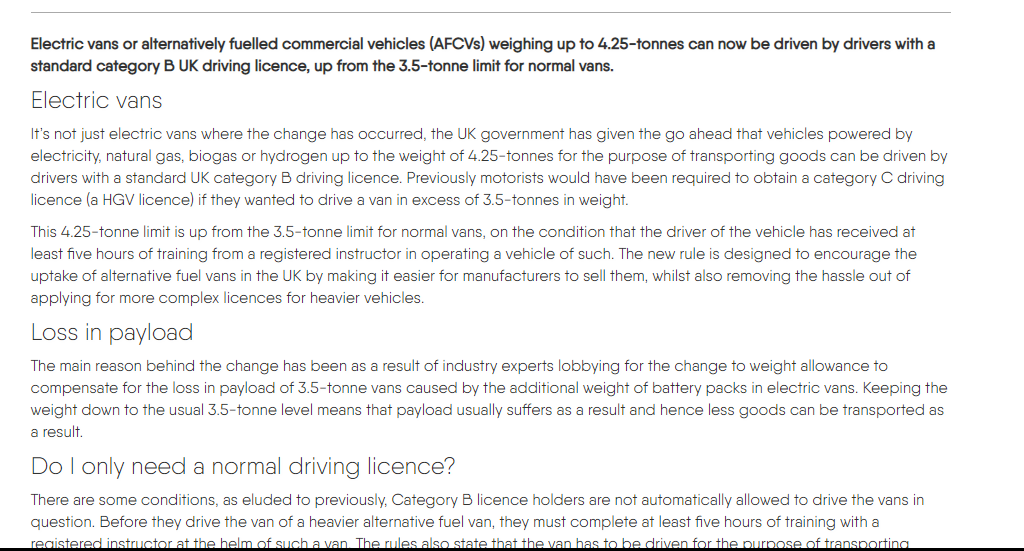

It is OK to drive vans up to 4.25 tonnes if electric on normal car licence (there will be certain rules to be met).
Therefore to suit government the rules can be amended.
