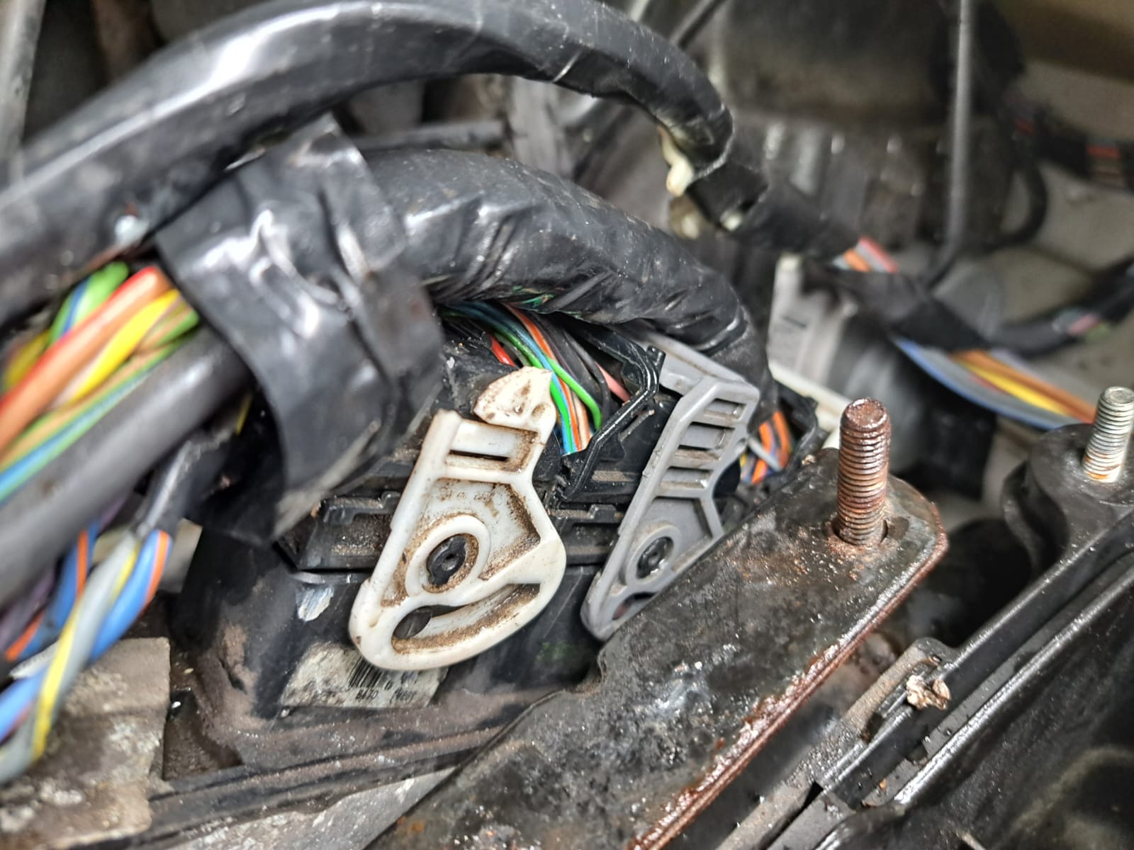

Eddie I hope you can help. I have a 2001 ducato 2.8 jtd I am currently stuck in Switzerland. Van is being passed from garage to garage racking up the bills. We got hit by lightning a couple of weeks ago. Since then the van won't startIf anyone gets this, if they email me a copy of there V5 I’ll post a crib sheet explaining how to by pass the Fiat immobiliser
Eddie is now retired.Eddie I hope you can help. I have a 2001 ducato 2.8 jtd I am currently stuck in Switzerland. Van is being passed from garage to garage racking up the bills. We got hit by lightning a couple of weeks ago. Since then the van won't start
The ecu has had immobiliser removed by the first garage but still no one can make it run.
What should we try next
2001 2.8 jtd. Common rail engine. All dashboard lights stay on engine turns over fine but won't start.Eddie is now retired.

Where and what on earth is that part?So AA have tracked the fault to this connector, the white part is brokenView attachment 786630
Just need to find a new one now. Anyone know where to get one quickly

It's part of the engine bay fuse boxWhere and what on earth is that part?
