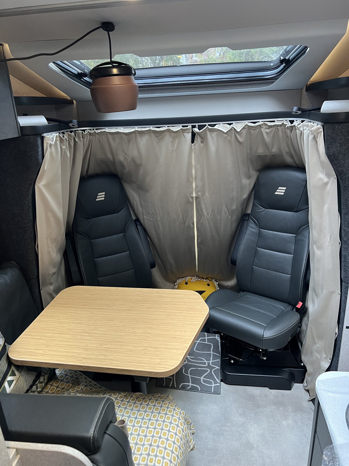

And this is what it looks like.... It makes a huge difference with the heating on as it keeps all the warmth in the habitation area. There are a couple of loops or tabs on the rear of the curtain - I assume to pin back towards the windscreen so that its doesn't hang so tight to the rear of the seats. Nothing to attach them to though ... another item for the to do list!

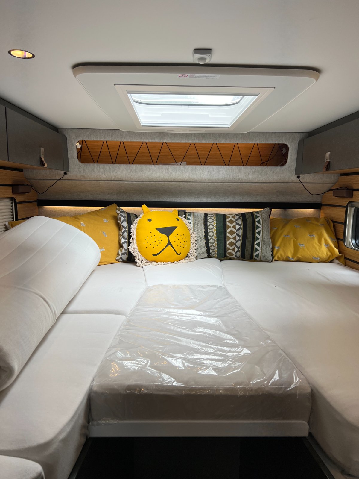

Sunday morning task ... Froli it !
The optional Hymer bed springs, black and gold in the pictures, are OK but I have a set of Froli springs which look and feel more substantial. So in they went! Another task that should have only taken an hour but ended up being closer to three.
About half-way through the first layout I realised that there is a directional arrow on the grid sections and rather than just merrily clipping them together and wondering why I had to many holes or to many tabs in the wrong place I should have read the instructions first..
Parts used: Froli Bed System

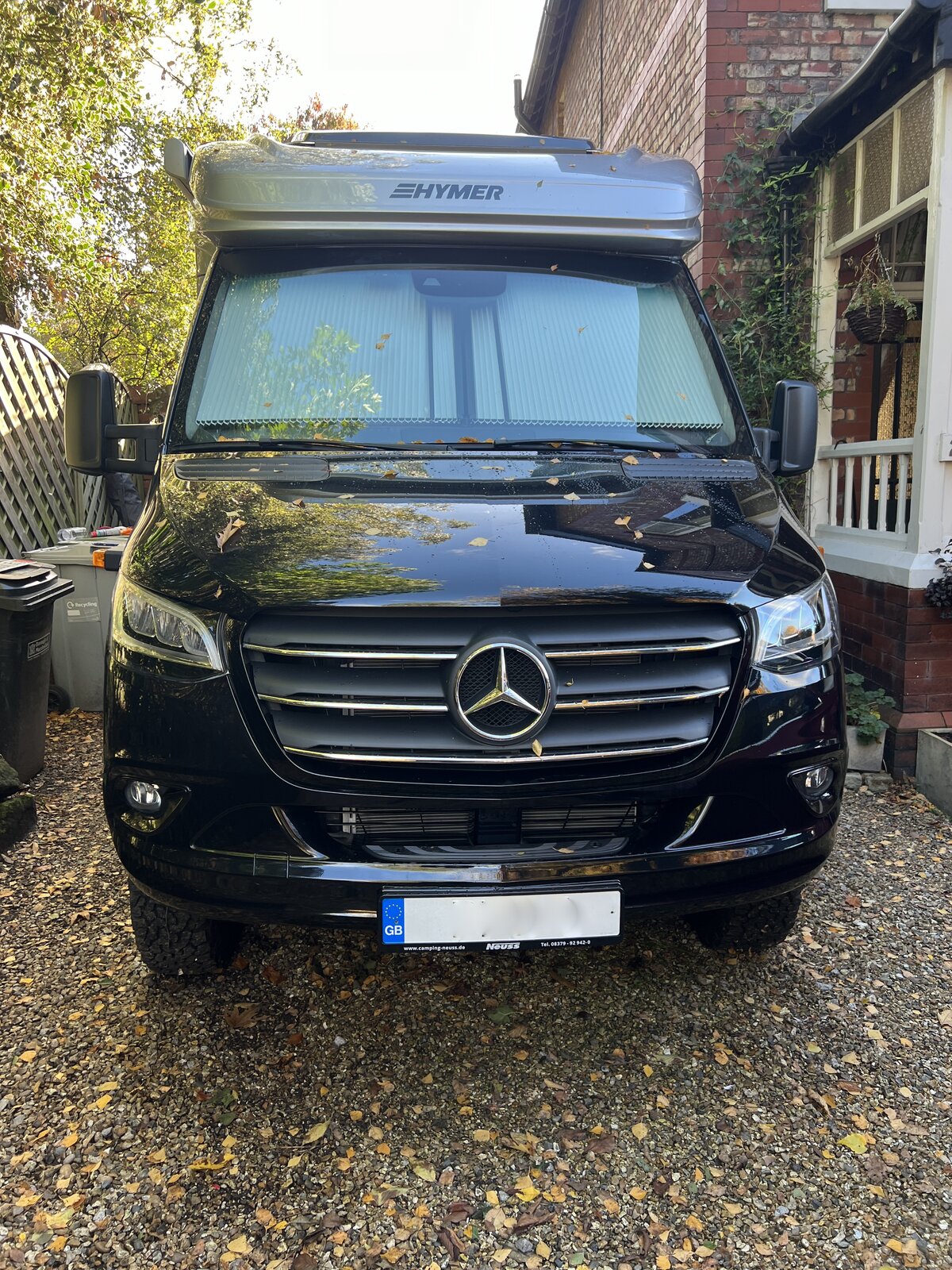

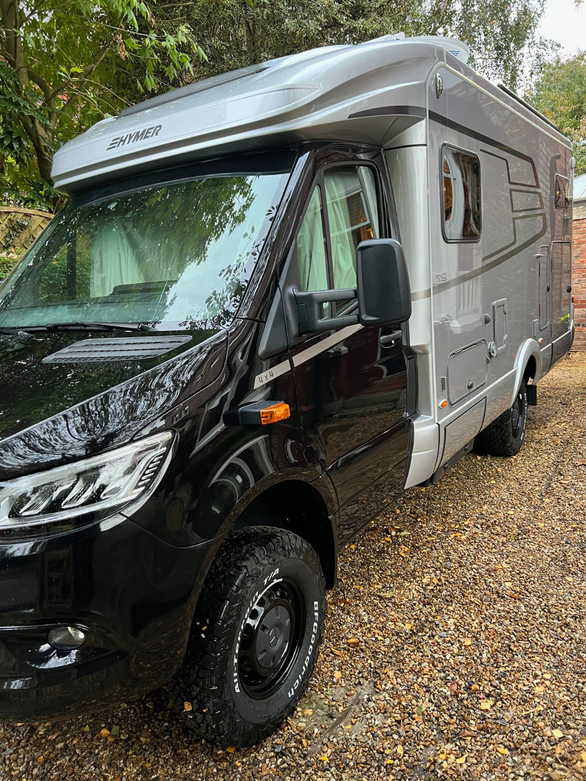

Done the black bits …. Just the silver bits to do now !
Finished polishing the silver bits!
It was such hard work....
Wash, clay-bar, machine polish with with correction wax, wash, machine polish with wax top coat, followed by ceramic coat to finish.
Nothing should stick to it now!
View attachment 964790View attachment 964791View attachment 964792View attachment 964793View attachment 964794
Interesting.
The 2016-2018 models came with a Froli system as standard.
Also in the earlier models the bit in-between the beds is wood right to the headboard.
We put a non-slip mat on it and its used for glasses of water, tea, glasses, phones, books and other bedside paraphernalia.
It's also interesting they have made the side windows by the beds smaller (good idea).
And the roof hatch bigger, although I'd have simply gone for a 16" conventional hatch rather than the bigger wind up version. I use the hatch to get onto the roof, and it's a squeeze!

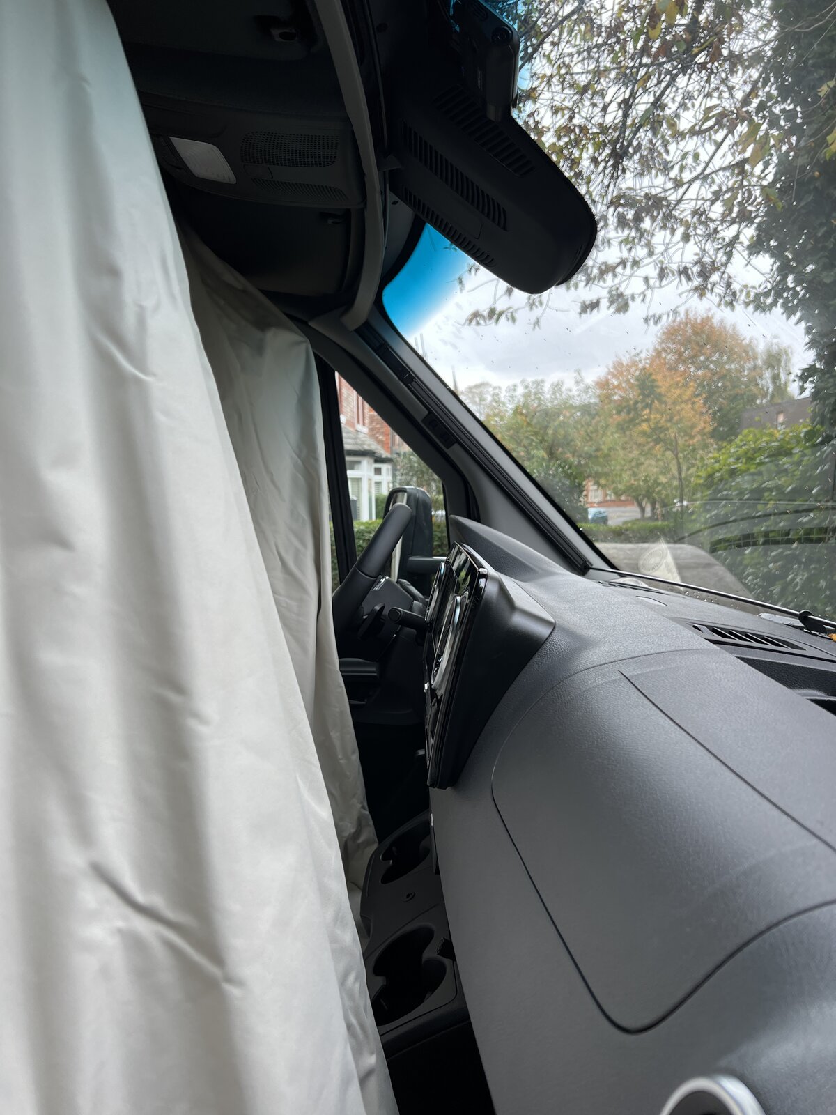

I like the curtains.
They look a lot better for keeping out the cold at the front.
It's interesting you have the Remis blinds AND the curtains.
If I bought the curtains, the first thing I'm removing is the rattling Remis blinds on the doors.
(I'll leave the one on the front windscreen as it's good to keep out the sun.)
I have the rails, but I'll need to add the poppers on the side though.

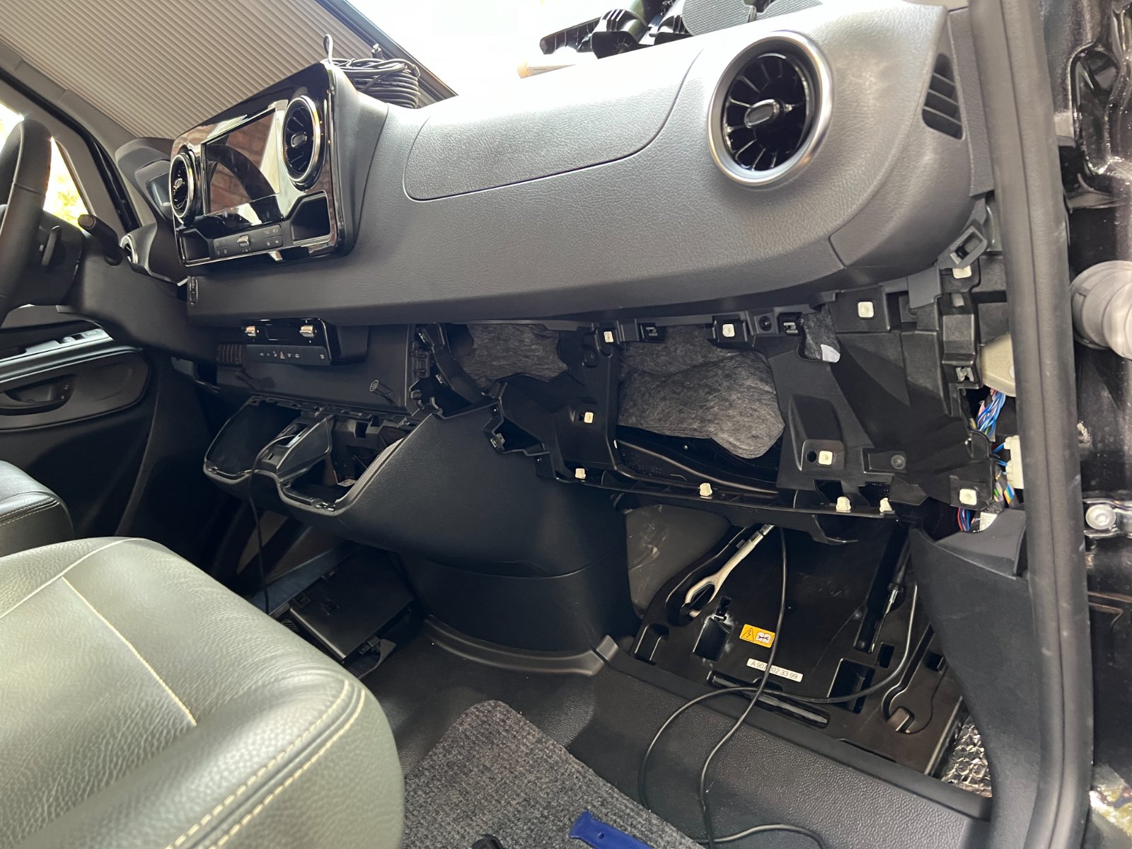

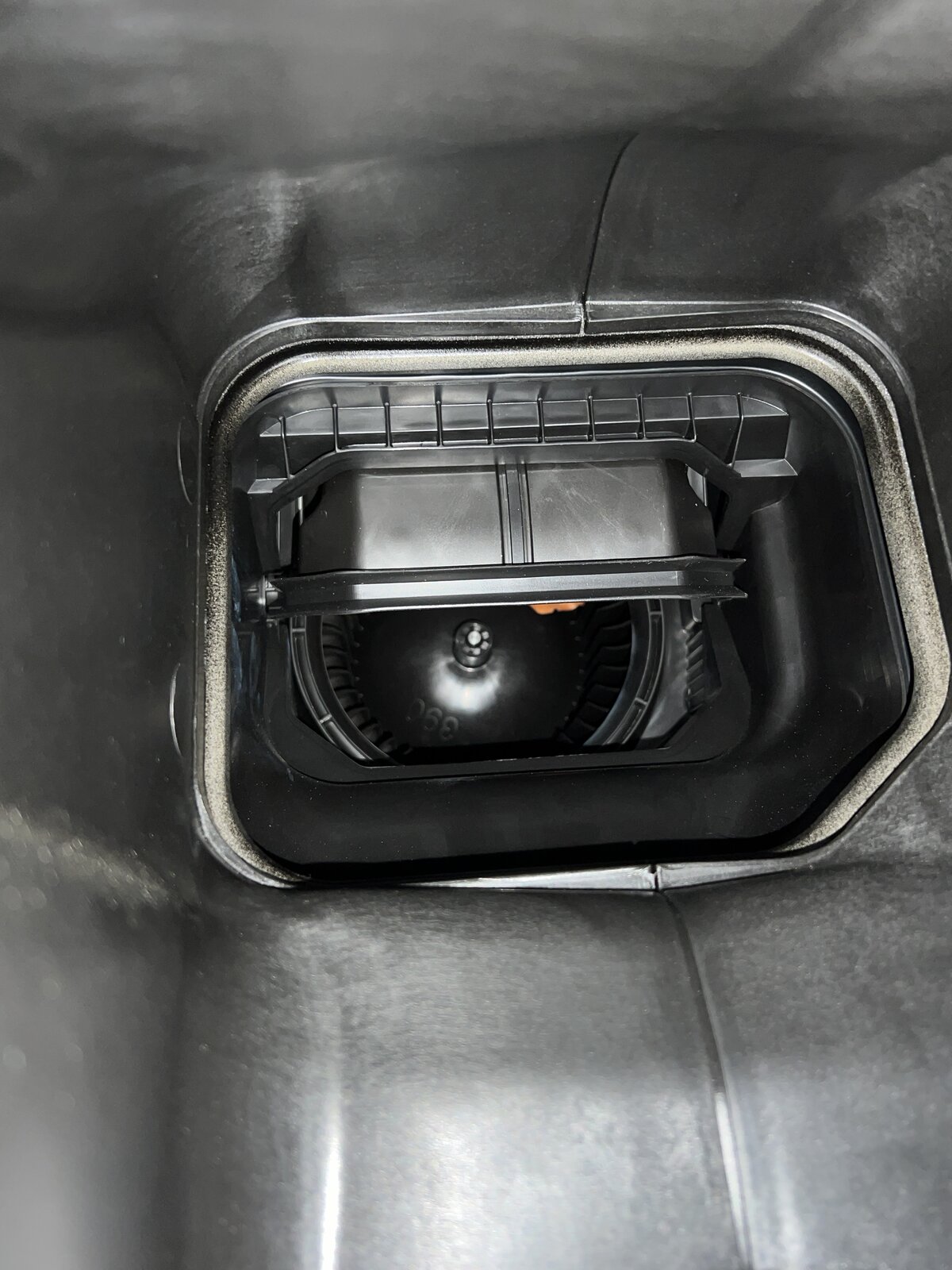

First Repair .....
My heating fan blower had developed a strange deep rumbling sound. Almost as though the bearings in the motor had failed, which seemed unlikely on a new vehicle.
I did wonder whether whilst, wiring the dash cam I'd knocked one of the vent tubes causing it to vibrate.
So…. I pulled the lower dashboard apart to get at the heating blower, but all seemed fine there.
Lifted the bonnet and inspected the air intake, I couldn’t feel anything down inside so I put the camera in to see if that would show anything.
I spotted something orange.
So vent off, and removed the offending article. One small leaf which must have dropped in one day when the bonnet was open.
Fired up the blower and all sounded normal again. I couldn’t see how one small leaf could have created such a noise.
To prevent it happening again I made a leaf guard grill using some leftover gutter guards.
Glad I didn’t drop it into Mercedes to look at, as pretty sure it wouldn’t have been covered under the warranty!
Curtains bring to mind my first MH, Winnebago, used to take ages to mop up all the condensation. Thank the lord for Silver Screens.
