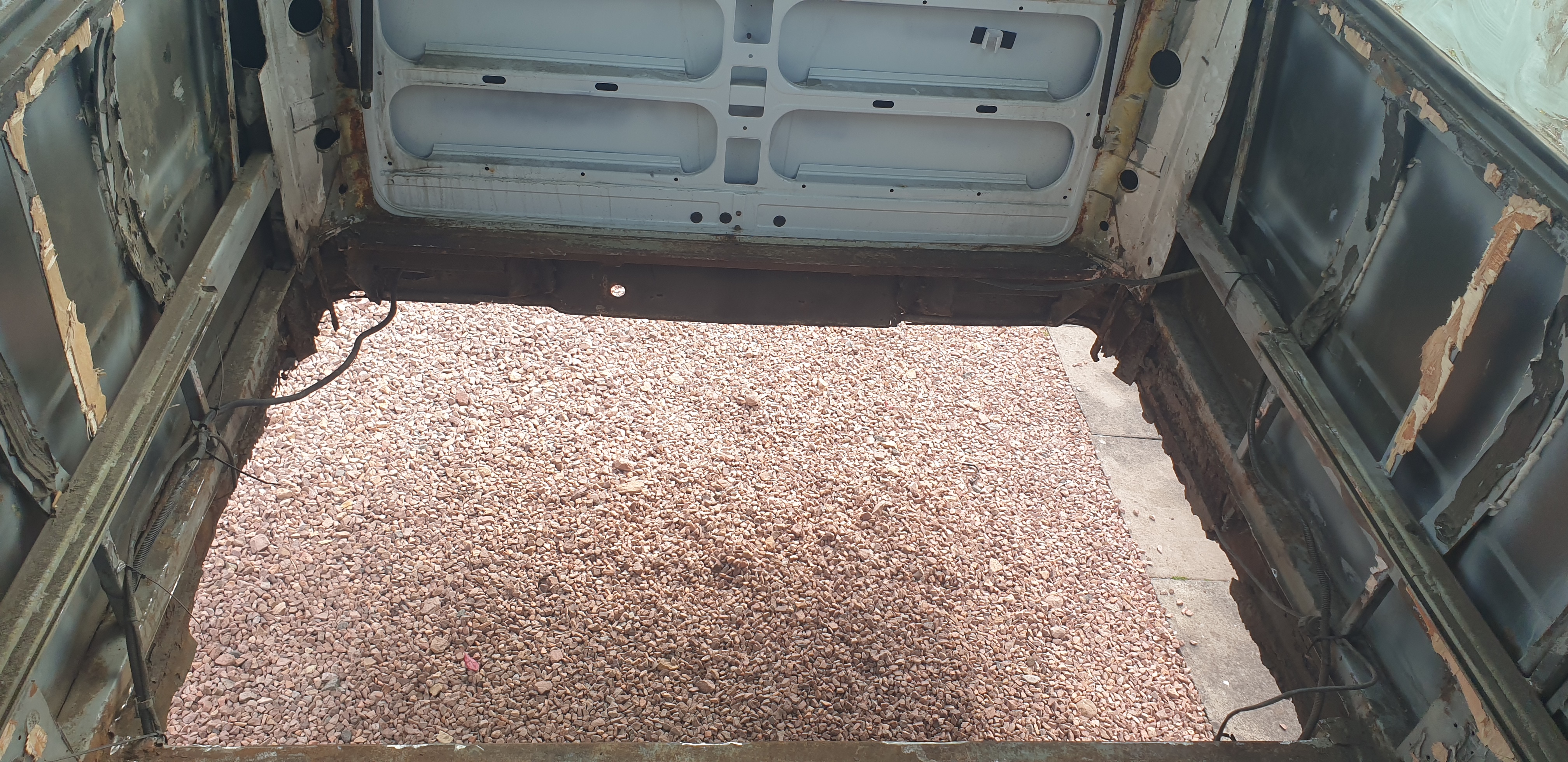

Where? passenger side where the steps used to be?!!!
Yeah ...theres a buddy seat in there wt the minute which overhangs the big hole in the floor 😁
I have the step and wheel arch on order but having trouble getting the sills and inner sills ☹️ they may have to be fabricated from scratch
Can't make omelette without breaking eggs.
Yep i keep saying that too. Theres no point in putting a wad of cash in to a van that isnt structurally sound ...ive seen a few of these builds that just seem to ignore the body etc and its going to cause probs in the future. Much easier to weld an empty shell than it is with a load of flamable stuff in it.
Although i have to admit its a bit daunting seeing it in its present state
At this rate... you'll be able to get it rated at under 3500 kgs...
It apparently still weighs about 4250kg at the minute . Thats what the scrap dealer weigh bridge said anyway. But once its all welded back up it will be fine.

Couldn't find one ...panel vans are rare in the uk ...ones with a side barndoor rather than a slider even rarer. Did find a few in germany around the 10k mark with similar mileage etc but you then needed to add another 3 grand to that to import it . Lots of busses came up for sale in the uk but regardless of condition id still have had to remove seats , interior etc . I wanted one with the tailgate rather than draughty rear doors and i wanted the 7.5 tonne ...many are only 6 tonne ...so thats how i ended up with this one. Granted theres more welding required than i innitially thought but at least when its all done ill have a solid base vehicle to build on and the load capacity i need for carrying a motorbike etc. Think it might take longer than 6 months to build though ...i may well be travelling next winter with a mattress in the back 😁
Great progress Tam! Having started with a lot of rust,by the time she’s done you’ll know exactly what you’ve got. If you’d started with something better you’d could have left a lot of trouble hidden.
Yes i agree ...theres been a few came up on eBay since i bought this ...and theres still no guarantee whats under a fresh coat of paint. The engine and chassis on this one are sound ...and passing a dvsa inspected mot with only the brake problem due to the lack of weight means its a pretty good base despite not looking like it at present. I could have bodged a lot of the bodywork and just started fitting an interior etc but its never been my way....even my old VW's got torn down before rebuilding
