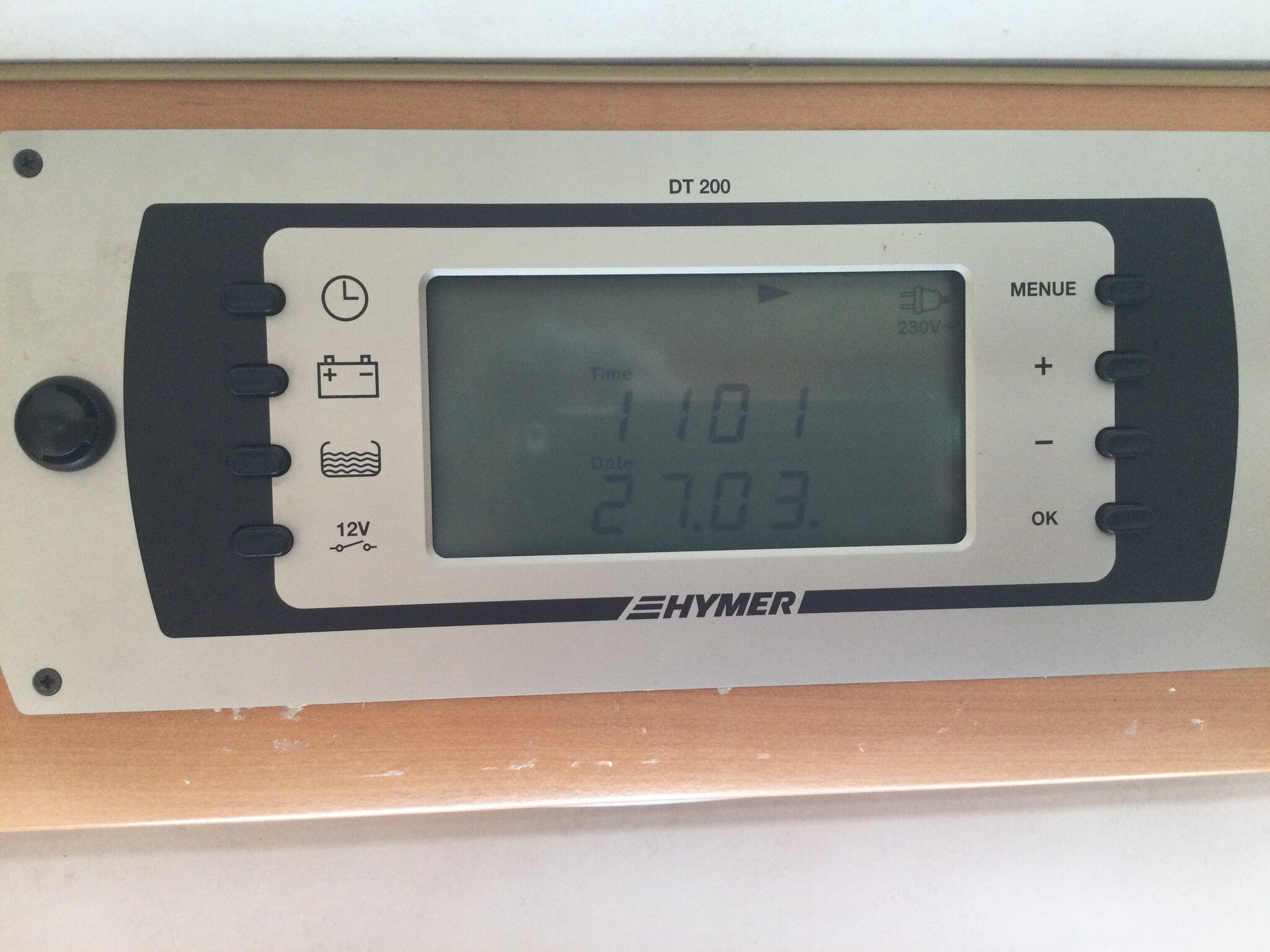

Sorry to butt in but I have a similar conundrum … Sounds to me like Lead Acid and Gel are not interchangeable….what about AGM ? Can you put Gel in to replace AGM without any further changes ?
Also how does one tell if the MPPT is capable of being set to Lithium or GEL for that matter ? Also how can you tell if the onboard mains charger is able to be set to GEL or Lithium…can you just look at the top of it.
View attachment 732036View attachment 732037
Top right on your first pic is the switch to change from lead to gel (Blei - gel) They say gel can be used for Lithiums although you are better to fit a proper charger with lithium profile. I haven't got my new charger yet so if my batteries do get too low I charge them on my elektroblocks gel setting and all has been good.
Bottom left on your elektroblock pic is (internus lademodule) - battery charger - I pull that fuse out if I am connected to hook up and don't want my batteries charged. This way they are only charged via my MPPT where you can change the charging profile to Lithium via the victron app.
As monzer says, there is a switch on the right to change between lead-acid (Blei-Saure) and gel (Blei-Gel). If you look at the manual you will see that the voltage settings are exactly the same, the only difference is that on the gel setting the 'absorption' stage at 14.4V is extended by a timer to last several hours. That is unnecessary for a lithium battery, and in this case it is better to switch to the lead-acid setting.
Other EBL models can only switch between gel and AGM, so that is why you will see the recommendation to switch to the gel setting, because the AGM voltage is higher.
If you want to connect a modern smart mains charger with lithium settings, you can either connect it direct to the leisure battery, or through that 2-way connector on the front. It's labelled Zus-Lade (= Zusatsz Ladegerate, Auxiliary charger). It goes through that fuse labelled Zusatz Ladegerate, to the leisure battery.
Ah right….I assume my AGM’s are fine with the Blei-Gel setting. Think I’ll stick to AGM’s. I notice my existing ones are only 850ah (got two of them). Can I replace them with 2 x 110ah or even 2x 200AH ….or is there a limit to the amount of AH’s that my Elektroblock
can charge.
So …. Excuse my ignorance but is a smart mains charger an add on to my Elektrobloc. How big is it ? No room in the cubby hole with the Elekrobkock….suppose I could lose the next storage cubby hole and put it there. Is it just a matter of connecting it into the 2-way connector Zus-Lade or are there other things to do.
