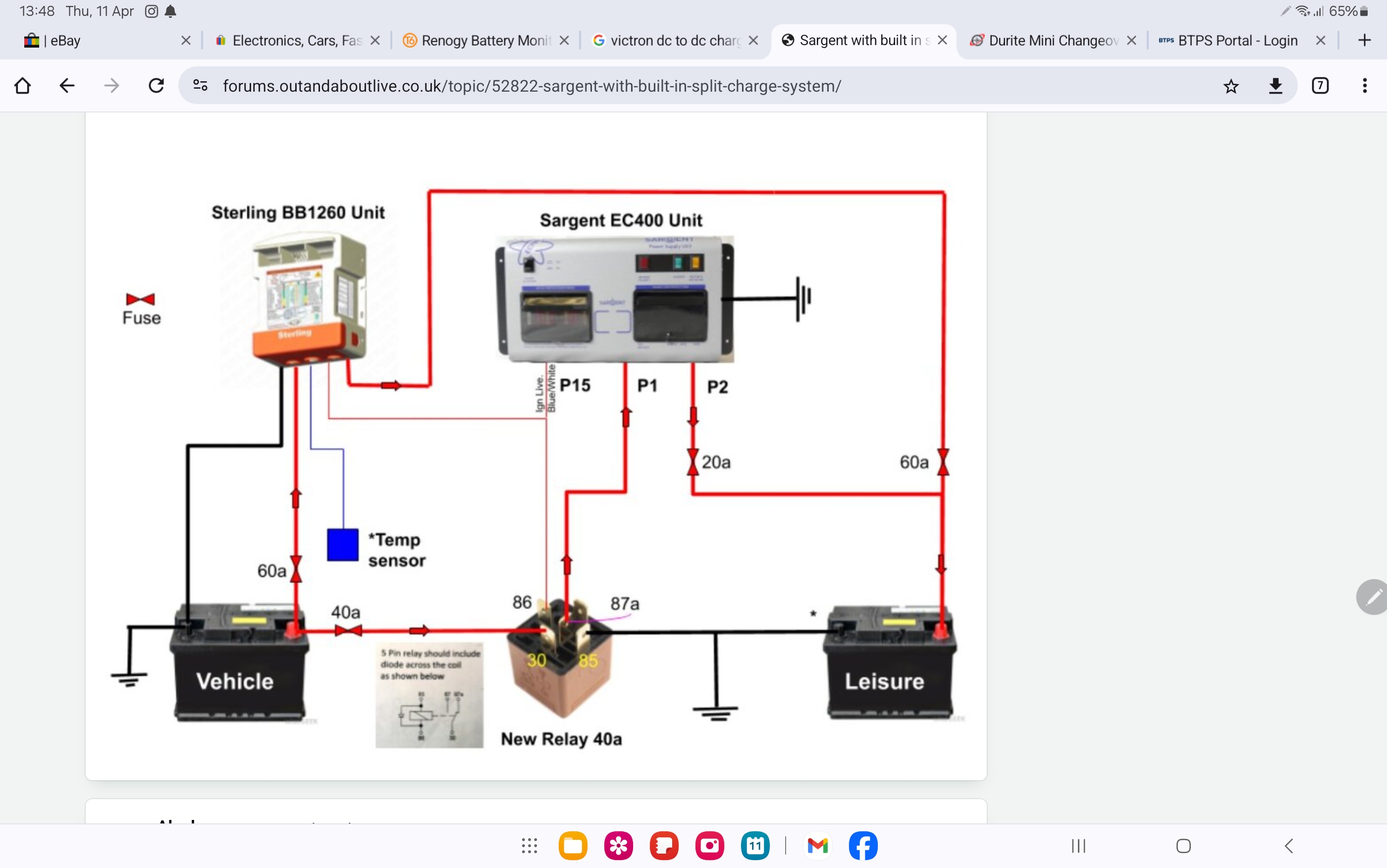

I installed a 120ah high output KS battery about 18months ago. We have the ec400 sargent system, along with the px300 mains charger in our autocruise carrera four. I also have a 200w solar panel connected to the ks battery directly, with the original 50w panel connected to the ec400.
The ks battery was sold as drop in, which it has been! It has worked perfectly, except for the accuracy of the bluetooth app, which appears to be a common issue with all lithium batteries. I fitted a renogy shunt, which is great, and an essential extra.
I also fitted a renogy 2000w inverter, and a victron 30a dc to dc charger. We use the factory fitted 800w microwave, which runs at 120 amps.
The whole setup has worked fine, with two 6 week trips around Spain, without hook up.
It has also worked okay when using hook up around the UK.
I have now fitted a relay in the system, to isolate the split charge relay, as suggested by another member, although I had no issues at all with it working in parallel with the dc to dc charger.(See diagram). It now charges at 30 amps, as opposed to 35 with both connected. There seem to be an awful lot of armchair experts regarding charging lithium, I am not sure that most of it is anything more than scaremongering!
I also wonder why people are worried about the BMS controlling the battery. Is it not like saying that we shouldn't rely on a thermostat to control the temperature of the van coolant?
That's really helpful thanks. I won't be doing it myself but it's good to know it's all worked with the Sargent system. It will useful when getting quotes from VanBitz etc as I'll need to make sure they add in these extras. It's a rapid learning curve for me and doing it on the fly (away) on tour is going to be interesting.
