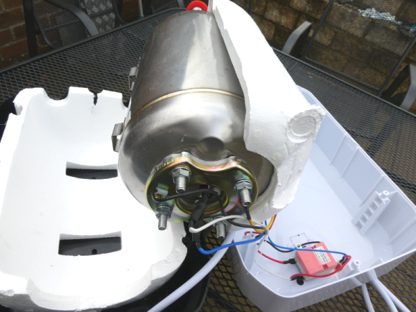

I know that you are not a fan of Chinese gear, but I bought a cheaper 240v Chinese 8Ltr water heater, replaced the 240 element with a 300 watt 12v element wired via a digitally controlled thermostat and switch to the load output on our Victron MPPT solar controllers.
The Chinese water heater was ideal as it has a 1/2" BPS inlet water inlet and outlet, a pressure release valve, over temperature cutout and a ready make case with insulation.
I plumbed in the new extra hot water tank via a 12v three-way motorised valve to switch between the existing and new hot water tanks.
If our lithium battery is topped up enough, then we can heat the extra hot water from the battery if it's a dull day and not a lot of solar.
The 300 watt 12v element I used was made up of 2 x 150 watt elements connected in series. We have 2 x Victron MPPT controllers, so I disconnected the two elements from each other and power the 2 elements independently via each of our solar controllers.
We can also heat the water while driving as we have a Victron XS B2B.
The original 240v element in the water heater was 1800 watts, so you could power it with an inverter if that was an easier route you prefered.

Thanks, that looks good. Sadly, I'm finding myself increasingly forced to buy chinese products due to the lack of alternatives.
In parallel, surely, not series?
