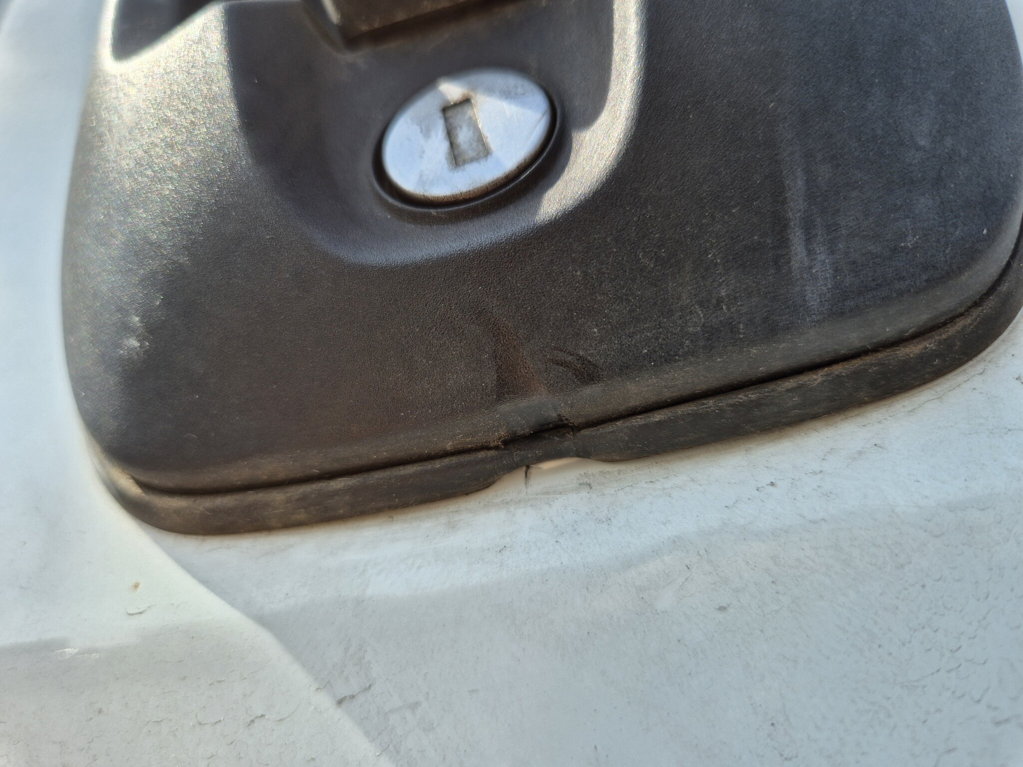

Yep. I would never have noticed it unless told to look for it. Thanks.They pushed a small round implement up under the driver’s door handle and popped the lock. Look underneath it carefully, you will see a mark.

Yes Riverbankannie, I posted a photo in my previous reply to your helpful post. It isn't a hole exactly, more of a little dent in the gasket and a slight mark under the handle.We did it ourselves using youtube videos to see how to access inside of door , remove Remis blinds etc. it didn’t involve anything difficult once you know how to remove things. I would think any motorhome repairers would do it.
Did you find a tiny dink under the handle?

I'm sure they can do either door & on transist definitely the mark6/7 it can be done on either the side door or the rear door but is far more difficult.It is also why i have a stainless steelplate on the side door directly over where any attack can take place to access the central lockingThey pushed a small round implement up under the driver’s door handle and popped the lock. Look underneath it carefully, you will see a mark.
As has been stated it can be disabled by accessing the control rod easily through the door .Fiat isn't the ony vehicle that is able to be opened this way but is the easiestf The passenger door was opening first then the entral locking was probably never engaged in the first place.

Yes he postedDid you find a tiny dink under the handle?
