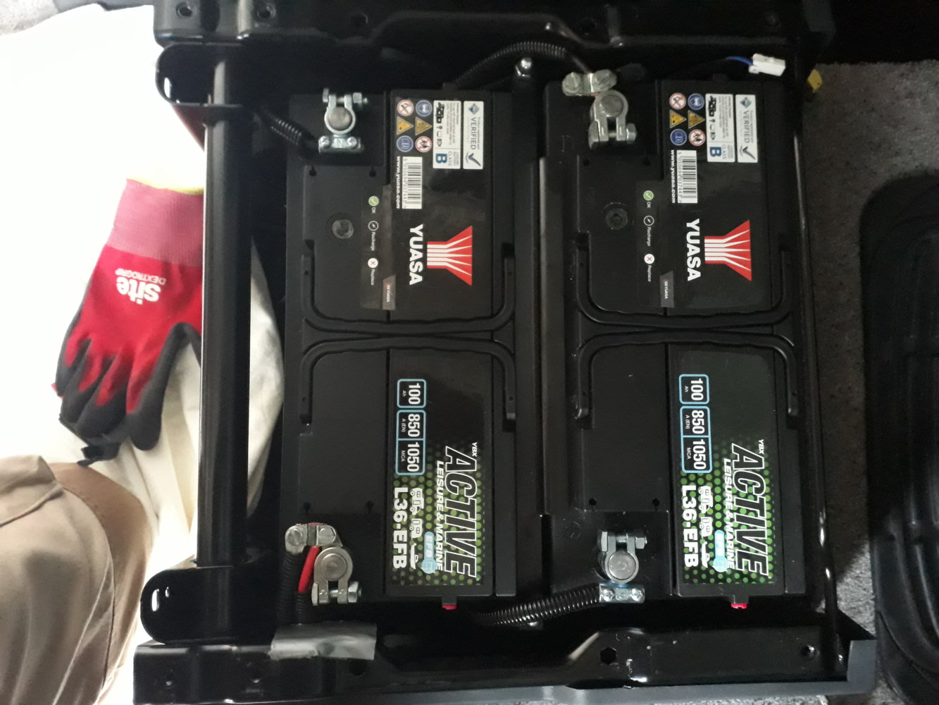

My apologies @lorger but I'm going to use it as a standalone 3rd-hab battery to power the TV and a couple of LED lights. I included this idea in #462 above as I think it will help my off-grid capability.

Also, be aware that the Yuasa L36-EFB (costing £120 delivered before discounts) is being sold from Halfords as an HBL700 and costs only £105, or £84 If you have a trade card.

If I bought from Halfords Mel then I would be sure to take my multimeter along to check first.
Yes I read the comment about one being under-charged when bought new too!

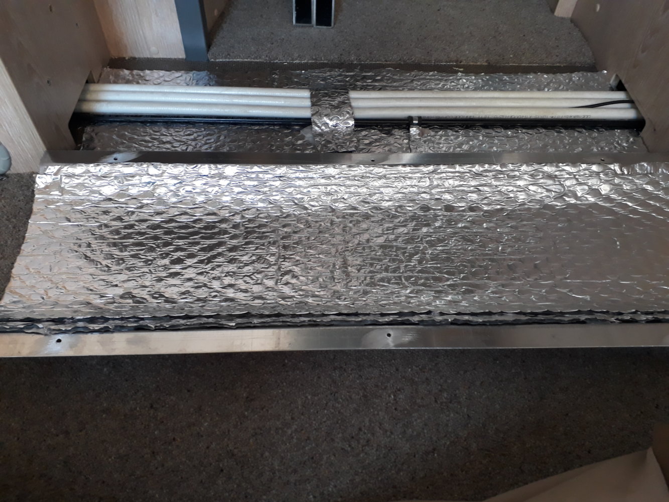

2. I then removed and metal foot guard in the galley area which protects the pipework. I set about double lineing the inside of the guard with thermal wrap and then single lined the floor. This area really does chill the van so it's worth doing. Note: The guard protects the three water pipes; a single gas pipe and the 12v power line that supplies the water pump:
