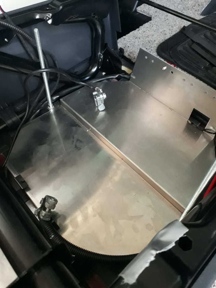

The cab is now ready for the arrival of the new Yuasa L36-EFBs.
I'm used to fitting lightweight seats in my cars so I almost but my back out when I lifted this bl○○dy thing. :D

Hi John (and Karen for info @Wombles):
The batteries under your Campscout drivers seat are level but under the Summit passenger seat (where my battery housing is located), the batteries are stepped.
They are designed to be like this but it's one more difference between the D and H-line models:
The stepped battery tray:
2. The difference in height between the two batteries once housed:

Thanks John, I was hoping to add two more battery terminal covers but I couldn't find any today in our local Varta battery supplier. I've not put the seat back on yet as I still need to add the venting tubes - I'll do that tomorrow.
I'm pleased that I've done the battery upgrade as I found the rear battery supports were loose; the negative wire was trapped in the lower frame (and damaged) and the AGM LA95 had no venting tubes attached and both venting appertures were fully open inward to the cab.
Both batteries came matched at 12.55v so I'm really pleased with that - it's a good start.
.........and I didn't blow up anything either, :D:D
