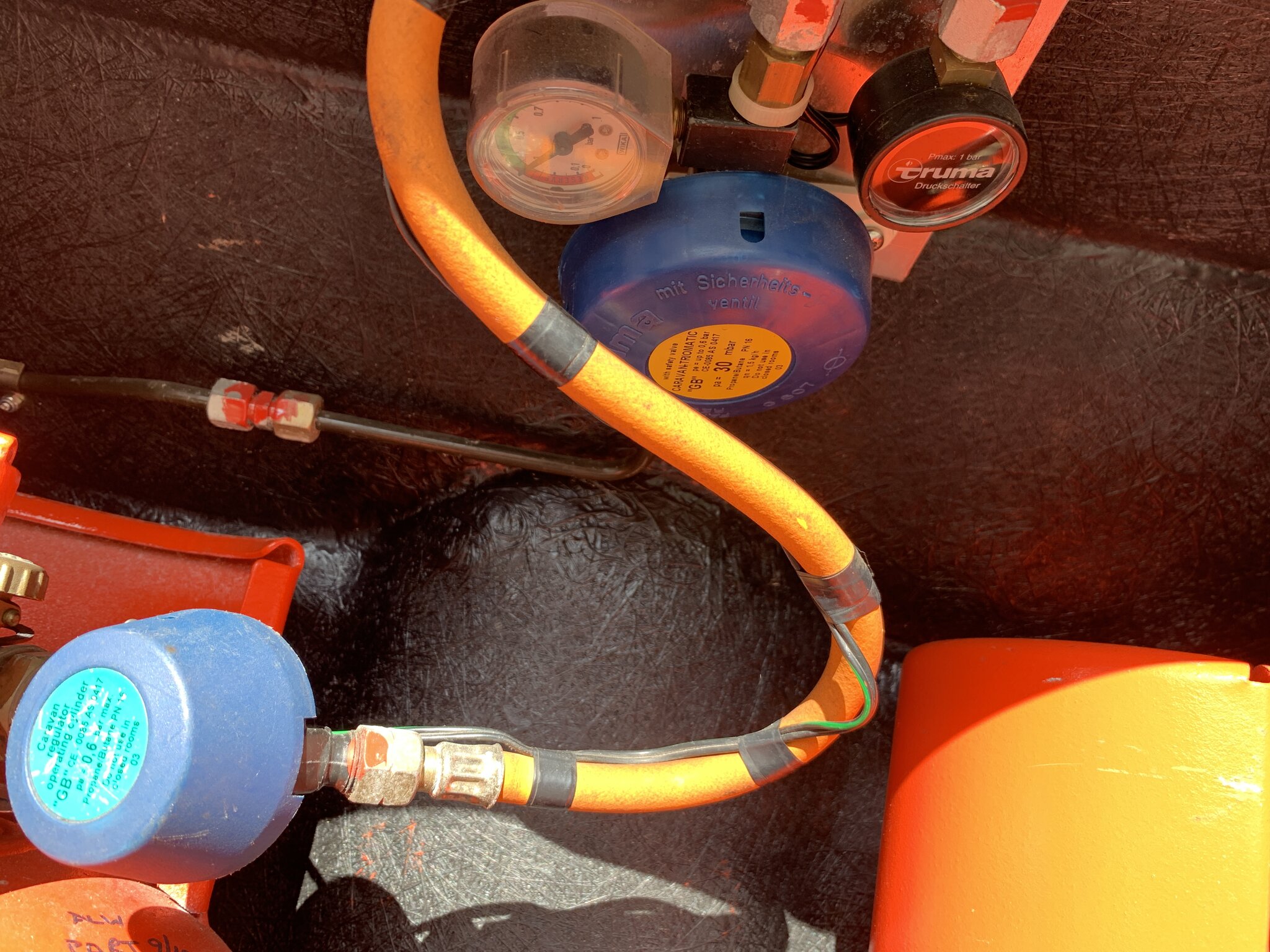

Bulkhead regulator - like this? So I could buy myself - one bottle kit (that includes the the hoses) and connect them all up and then take a deep breath before drilling a big hole in the skirt of the van and I should be good to go?

That's confusing you appear to have both a bottle top regulator and a bulkhead one but you should be able to connect just to the bulkhead regulator.

Mmmm - you are right. This picture shows the set up that I currently have a bit better. Why would it have ben installed this way - any thoughts?
My plan is ditch the 6kg bottles and have one 11kg one.
Crazy, I think you are lucky to have any gas in the van, as there won't be enough gas pressure for the bulkhead regulator to work.
Not sure I agree with you there. There are 2 regulators for each supply but surely if the pressure has already been reduced by the first reg the 2nd one will 'recognise' it's already at the right pressure so won't restrict it further?
You need pressure to open the diaphragm.
