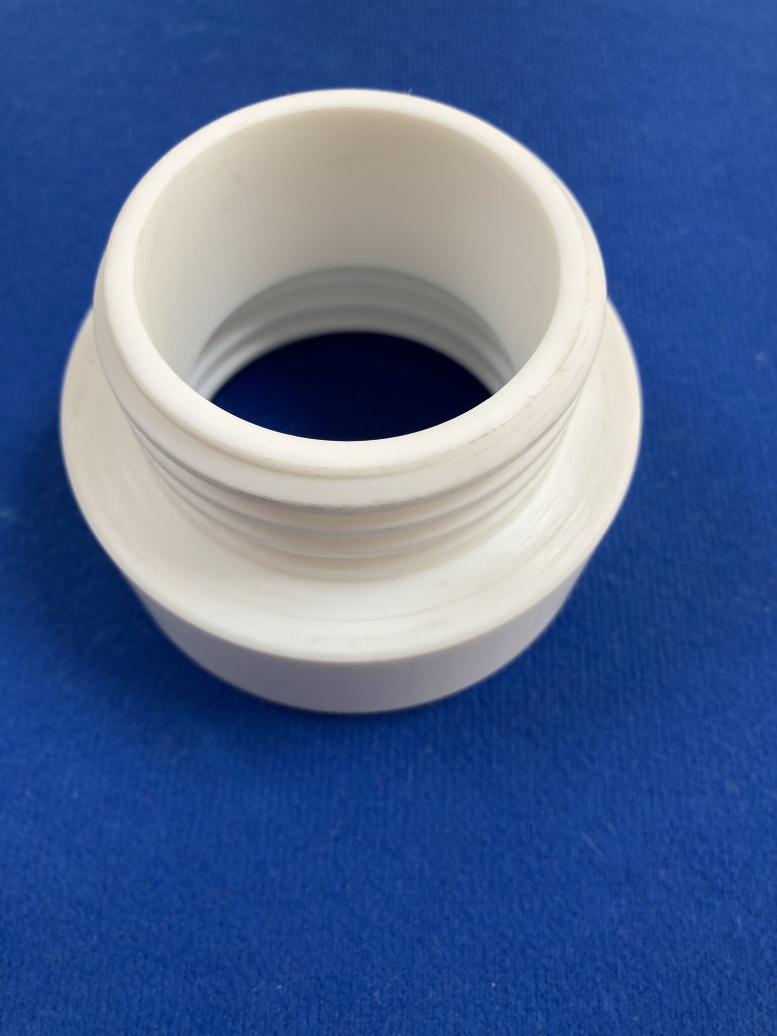

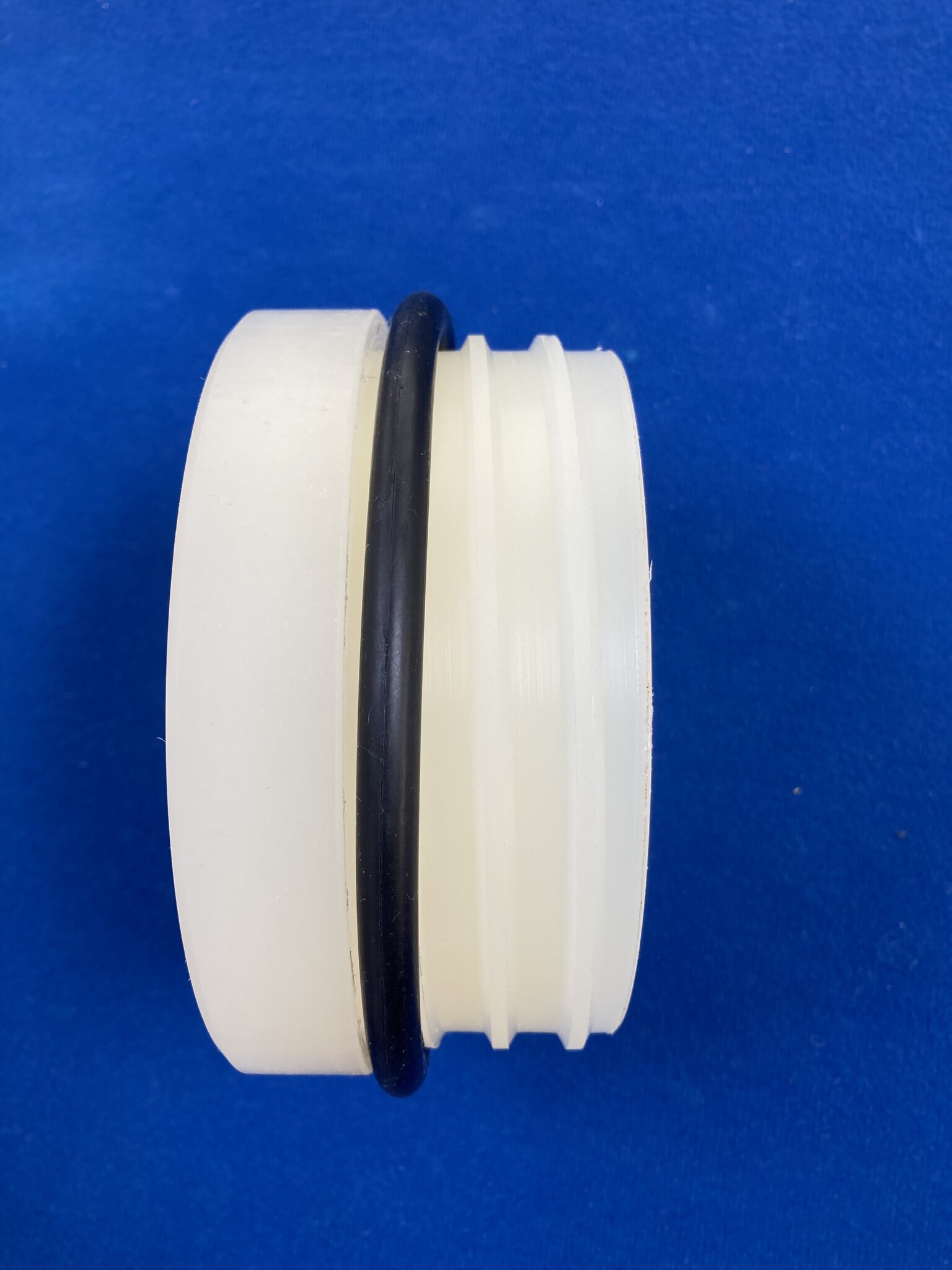

The big red inspection cap can leak as it has a foam seal, Burstners solution is to fit an 8mm rubber O Ring, sadly that only leaves 1/2 turn of thread holding 120 litres of water in a full tank😱
I emailed Belplast who make the caps and suggested they made the thread longer, but they sadly just ignored me.
I have an engineering background and had a friend make me a new one out of food grade nylon, now I have 2 full turns and the 8mm O Ring holding the 120 litres in the tank on roundabouts, I don’t worry any more!
