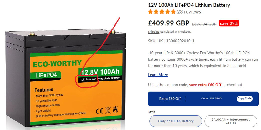

You didn’t but at least I was able to help you with the difference of Lithium Ion and Lithium Iron Phosphate LiFePO4

BTW You didn’t thank me for pointing out that there is no such thing as lithium iron, but your welcome 😉

"BTW You didn’t thank me for pointing out that there is no such thing as lithium iron, but your welcome 😉"
It was an abbreviation/shortening of the full name and is commonly used in other leisure sectors, no need to thank and I stand by what I said.
