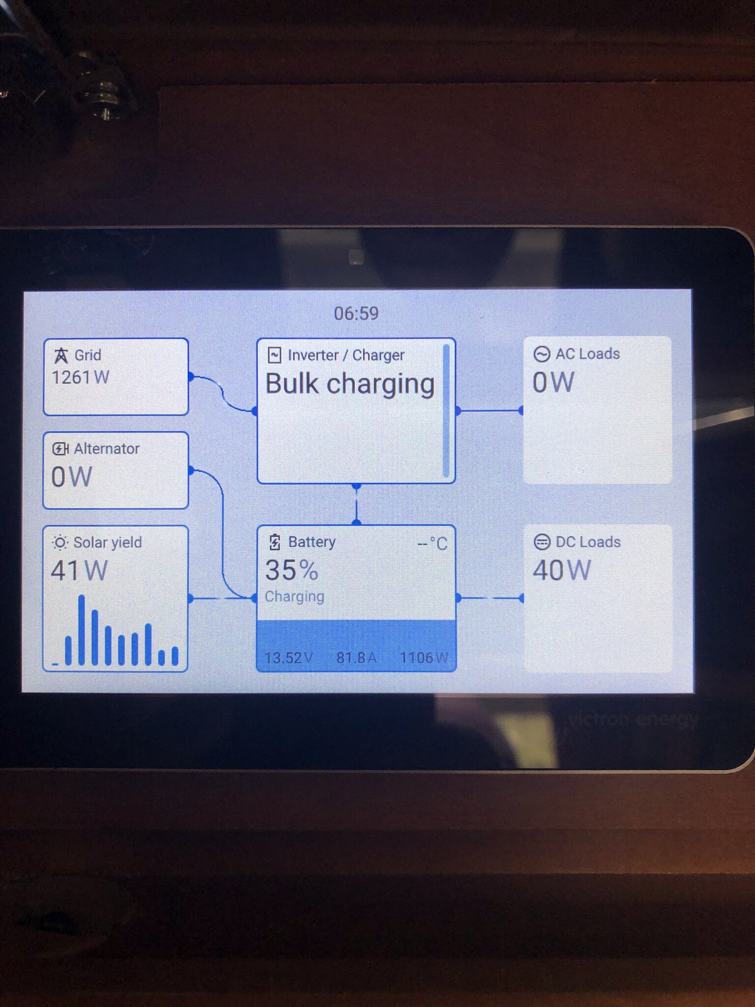

So I rolled up to an aire yesterday, 56% on the batteries (600ah lithium) I was next to the leccy bollard which had €1.99 credit on it so I plugged it in and began charging up to around 80%. The weather was atrocious so I put another €2.00 to bring it up to around 100% and that was around 8.00pm. We went out for dinner and the balance was €0.00 BUT left the plug in, came back and watched two hours worth of tv (12v) and went to bed, still with ehu lead plugged in! Woke up this morning NOTHING that’s 240v plugged in, only usual phone charging and 12v FF in garage, alde OFF, fridge on gas and my batteries was 26% so it’s used around 65-70% overnight!!
Can anyone explain this??? Lenny HB RogerIvy anyone??

So with the settings I had on alde and I’ve just replicated it whilst on ehu, the multiplus is doing its job perfectly in that it’s topping up the electric with what’s coming in from the bollard, so even with hook up there’s a deficit, so if the ehu had run out of credit the deficit and would have been far greater a draw through the multiplus hence depleting the batteries!

All charging up now, up to 53%
